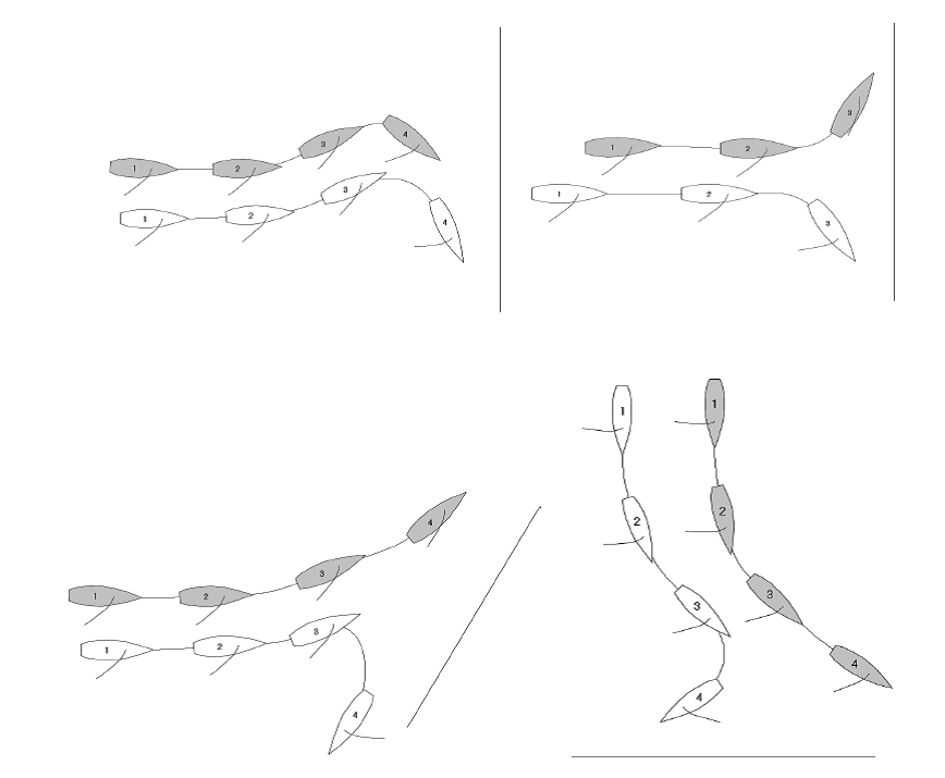

Leaving my original scenario aside and using your diagram, in which the boats are on the opposite tack, it's the 3rd diagram I'm mostly interested in. Let's say there's a mark at the right hand end (for the boats, off the bottom of the picture for us) of the obstruction and L (yellow) has luffed up W (blue) who is attempting to pass to windward. L is, by any usual meaning of the word, the "inside" boat. It appears she can force W (blue) into a position where she can no longer bear away before bearing away herself and taking the mark.
Is this correct? Steve = : ^ ) P.S. I assume the umpires call is from match racing and I don't understand the significance of the Y and the green and white flags.
Yes, in the third diagram in MR Call B15 (bottom left) Y is the leeward, inside boat, entitled to both right of way (rule 11) and room at the obstruction (rule 19) throughout.

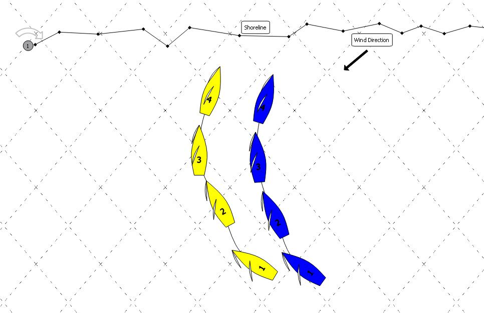

Is this diagram something like your original scenario? ![]() @3 Y is something like exactly 90 degrees to the shoreline, but, as previously discussed, we can't be sure, so last point of certainty is she is overlapped outside B. If B is running out of water, boats are at the obstruction and Y must give B room. @4, Y is clearly past 90 degrees to the shoreline and becomes the inside boat (as in the above MR Call). If Y can get to this position without failing to give B room, she is as good as gold. Consider: this situation is no different from taking a boat the wrong side of the mark, while outside the zone at any ordinary mark. And in match racing flag Y is displayed by a boat to signify a protest, Green and White Flag in response by umpires means no boat is penalised and a penalty is signified by a Blue or Yellow flag corresponding to the colour of the boat penalised

Yes, this is the situation (except that the wind was a little further aft). I'm kind of surprised that, as long as yellow aims roughly at the mark and blue is "inside", then blue has rights, but if yellow luffs up to the point where she is closer to the obstruction than blue, then she can force blue out, then bear away herself. It may seem difficult for her to do that in your match race diagram but, she may be a bigger boat, and may be further ahead than in the diagram.
A boat can only take another boat the wrong side of a mark if she also goes the wrong side, correct? Here yellow bears away at the last minute to take the mark, but has forced blue to tack and gybe (or tack back) to get there. Thanks for all this, Steve = : ^ )
