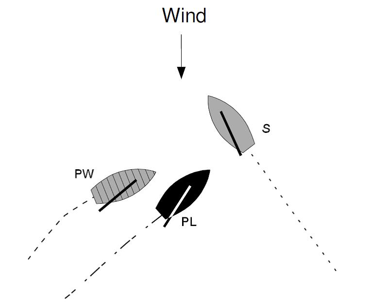

I was in a race this evening and, on starboard tack and beating to a windward mark, two boats on port tack approached on our port side. The boats were overlapped and I'll call the leeward boat L and the windward boat W.
There was some disagreement after the race about W's rights. My understanding of the situation is this: If she'd wanted to, L could have hailed W to tack to avoid us and W would have had to respond by either tacking or hailing "You tack!" back at L, and then allowing L room to tack. However, we were nearing the windward mark and neither port tack boat wanted to tack, and L came away just enough to pass behind us, but she didn't leave room for W to do the same,and W was forced to tack. I believe that, as a starboard tack boat, we were an obstruction to both L and W, and that, as L chose to pass to leeward of the obstruction, W could have hailed for room to pass to leeward also. Someone else believed that, as W had the option of tacking to avoid us, she _didn't_ have rights to hail L for room to pass astern of us. Who's right? Thanks, in advance, Steve = : ^ ) |

CASE 11 When boats are overlapped at an obstruction, including an obstruction that is a right-of-way boat, the outside boat must give the inside boat room to pass between her and the obstruction. Rule 19.2 Giving Room at an Obstruction (a) A right-of-way boat may choose to pass an obstruction on either side.
19.2a looks like a red herring to me. In this case, W is NOT the RoW boat, is she? Ignoring the obstruction, L holds RoW. Does this change due to the introduction of the obstruction? If so, at what point does W acquire RoW?
19.2b says what case 11 above says... |

Noah, I think the 2nd part of Brass's answer has to do with what would have happened if L had chosen to tack. But once the decision to bear away is made, then room must be made for both boats.
Sorry work is manic at the moment! But that is exactly what I was thinking of so W can either call for room or tack away.
I imagine Brass meant to paste in 19.2 (b) as well
I don't think there's no actual requirement for W to hail for the room, although it makes sense to do so. So yeah, reckon the OP is correct. |
Didn't mean to be snarky and apparently I was a bit cryptic <g>. I think you are missing the point. L, not W, is in control and has the choice which side of S to pass on. L has the choice. If she ducks behind S, she must also give W room in accordance with rule 19.2. If she wishes to tack away, she may give a rule 20 hail and W must respond. Nobody 'calls' for anything except a round of drinks afterwards. Case 11 is the standard exposition of this situation and it's described in every commentary ever written. CASE 11 Definition, Obstruction Rule 14, Avoiding Contact Rule 19.2(b), Room to Pass an Obstruction: Giving Room at an Obstruction Rule 20.1, Room to Tack at an Obstruction: Hailing Rule 21(a), Exoneration When boats are overlapped at an obstruction, including an obstruction that is a right-of-way boat, the outside boat must give the inside boat room to pass between her and the obstruction. Summary of the Facts ![]() PW and PL, close-hauled on port tack and overlapped, approached S on the windward leg. PL could pass safely astern of S. PW, on a collision course with S, hailed PL for room to pass astern of S when PW and PL were about three hull lengths from S. PL ignored the hail and maintained her course. When PW bore away to avoid S, she and PL had slight beam72 to-beam contact with no damage or injury. PW protested under rule 19.2(b). The protest committee held that rule 19.2(b) did not apply, stating that PW could easily have tacked into the open water to windward to keep clear, and should have done so. PW was disqualified under rule 11 and appealed. Wind Decision S was an obstruction to PW and PL because both PW and PL would need to change course substantially if they were sailing directly towards S and were one hull length from her, and because they both were required by rule 10 to keep clear of her (see the definition Obstruction). Under rule 19.2(a), PL, as the right-of-way boat, was entitled to pass S on either side. She chose to pass to leeward of S. Therefore, under rule 19.2(b) PW was entitled to room to pass between PL and the stern of S. PL did not give PW that room, so PL broke rule 19.2(b). PL was subject to rule 14, but since she held right of way over PW and there was no damage or injury, she is exonerated for breaking that rule (see rule 14(b)). PW could not have known that PL was not going to give sufficient room until she was committed to pass between S and PL. PW broke rule 11, but she did so while sailing within the room to which she was entitled by rule 19.2(b). Therefore, as required by rule 21(a), PW is exonerated for breaking rule 11. Also, when it became clear that PL was not giving room, it was not reasonably possible for PW to avoid the contact that occurred, so PW did not break rule 14. PW was not required to ‘tack into open water to windward to keep clear’ because PL did not hail under rule 20.1 for room to tack and avoid S. Had PL hailed, PW would have been required by rules 20.2(b) and 20.2(c) to respond even though rule 20.1(a) prohibited PL from hailing because she did not have to make any change of course to avoid S. PW’s appeal is upheld. The decision of the protest committee disqualifying PW is reversed. PW is reinstated, and PL is disqualified for breaking rule 19.2(b). Edited by Brass - 06 Jan 14 at 9:32pm |
Thanks Brass.
So L decides but if they decide to duck (or pass astern even if they do not need to change their course) rather than tack they must also give room for W to pass astern.
Yes.
Actually, in the scenario diagrammed in Case 11, PL may NOT hail for room to tack, because she is already sailing a course to pass clear astern of S, and thus she can avoid the obstruction safely without making a substantial course change, so rule 20.1( a ) cuts off her entitlement.
