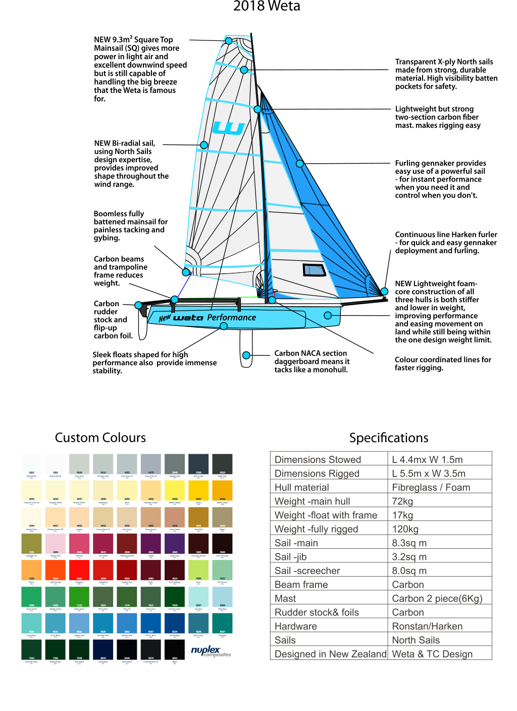

The switch to foam core and sail upgrades haven't made any significant difference to the price and the 9.3SQ sail is approx £120 option (the pin-head 8.3 main is still standard) with a new boat. The switch to the new Harken continuous furler did result in a small price increase. I found some pricing from the previous UK dealer which was around £15.7K for the foam core boat including trolley and all sails, but I can't speak for the current UK pricing.
You still have to work to keep the boat upright (flat is fast) in a Weta but unlike most non-trapeze monohulls, no abs of steel are required and, unlike trapeze boats, it won't leave you crippled from compressed vertebrae. Here's some footage from the World Masters Games where 50 Wetas competed (30 sailed solo) with crew ages from 35-85 - and two Paralympians finished in the top 20. There aren't many family-friendly dinghies that will go over 20 knots and can be sailed/raced with or without crew in almost any conditions. It has built-in stability and there's never a death roll to worry about - a (very mature) Weta sailor in Scotland(!) survived a 57 knot gust which capsized the fleet but (with the optional furling jib) he was the only one who stayed upright. OTOH, a 13yo beat the Weta fleet in a Championship race in Queensland last weekend. I sail in a mixed fleet on Sydney Harbour and at the pointy end with the Flying Dutchman and 505 and usually beat them in anything over 15 knots usually by a big margin in winds gusting over 25. This is one of my races. It's a great all-weather boat. Mostly you just sit on the floats upwind in a blow which gives you incredible leverage - and there is an optional chest harness available which supports your torso - great for long-distance races (Wetas have completed the 300 mile Everglades Challenge) or sailing solo when there's no support boat around. In the light stuff the new SQ sail helps to keep you moving and you can also use the flat-cut gennaker as a "code zero" - you can't point that high but you can still keep moving past the flip-flopping monohulls. I've raced solo in winds over 35 knots and even though it will often recover from impossible angles, I capsized when I got wiped out by a big gust with the main cleated (doh!). But all you do to right it is to undo a port on the back of a float to flood it and it comes up like a monohull. However, unlike a monohull, the flooded float prevents it from turtling again. Then you sail upwind until the water pours out of the flooded float, lean back to do up the port and you're back in business - it takes about 5 minutes with no outside assistance required. I think "visual elegance" is subjective - think of it as a skiff with stabilisers. Trapeze boats were seen as ugly back in the day and foiling moths aren't exactly beautiful. But I appreciate good design and the use of modern materials because it means I can spend more time on the water and don't have to break my back to do so - the heaviest component you need to lift is the 15 Kg float while inserting the arms into the main hull and the carbon mast only weighs 6Kg. See the rigging video below As for a foiling Weta, they developed a prototype 8 years ago but decided the market wasn't big enough, the stresses on the design would be much greater - especially when you have the inevitable crash - and the insurance liabilities even greater. And then you need somewhere to store it - the Weta packs down to the space of a Laser and takes 20 minutes to rig. There are now foiling tri's but I doubt sales of the F101 and Mantis have been huge. Personally I think the UFO is a great foiling trainer but anyone who is serious about solo foiling gets a Moth or A-Class or for a 2-handed foiler gets a Nacra or Phantom - everything else has struggled to get any traction in the market. But even in Australia, where I now live, and we generally have more water space compared to the UK, the number of foiling boats is small and in the UK it's probably even more so - apart from the Moth fleet.

New revised Weta introduced for 2018 with larger 9.3 SqM square top mainsail (compared with 8.3SqM pin top original), recut bi-radial sails, lightweight foam-core hull construction and custom colours. ![]() Edited by Pewit - 12 Oct 18 at 5:48am |
