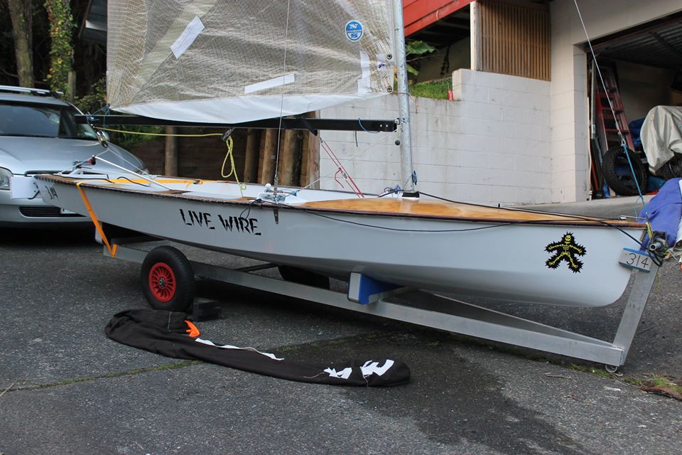

Nice Farr 3.7 for sale here:
https://www.facebook.com/3.7Class ![]() |
