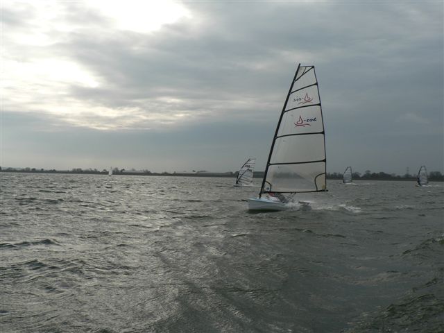

The point is when the wind gets mental, you dont want to have to go and change the sail to cope with the conditions. In the picture the wind was pretty ruff (gusting 5 for sure) So in my opinion the rig was doing the right thing....spilling power. BTW if I wanted to keep the power on all I had to do was put some kicker on and all would be fine (would deffo do that in the lighter stuff = more power) Doubt you can get that sort of adjustability on a board, hence the early doors sail change. If in that wind I was to wack loads of kicker on I would never get downwind without wanting to nosedive....you (GRF) would know this as you have mentioned before about the Blaze having the same problem. We could argue all night about what is right and wrong with different boats, but it's completely pointless. Tim |
So GRF what's wrong with this mast here then? Check out the windsurfers in the background trying to keep up. |
G.R.F. ......I don't quite understand what you're saying. If I type windsurfing
into google images, I get tons of pics of windsurfing rigs powering along, with the top of the mast bending off sideways taking the top of the sail out of action. Which is seemingly the same as what is happening with the D- one rig. |
Well it's probably pointless given the circumstance of this particular
thread, if you want to debate the ins and outs of rig control and sail twist from limited controls I can wax poetical all night, but then that's not going to help you sell boats is it? So, I've made my point and I shall leave you to continue to enjoy in innocence you're wonderful new toy. The Blaze nosedive issue is a rocker not a rig issue, an issue I think a spinnaker might alleviate a tad, but I never got that far and it's not that big an issue as it happens, it's never gone all the way down the mine like Bethwaites wonder machines, it's just a 'build your confidence it wont' thing that needed to be overcome. |
Lucky you didnt sail the original rig then....that's why they changed it. You could have called yourself "stinky pete" (look it up) the amount of mining you had to do. But change it they had to, after a go-live.....unlike this mast that has already taken that behaviour into account. I don't sell them, but I am sure as hell enjoying sailing them. Tim
We can start another thread for you to tech us, I'd love to know where I've gone wrong in ten years of reasearch and experement on lift theory and composite engineering. I'll call it GRF's rig school, I'm all ears! |
