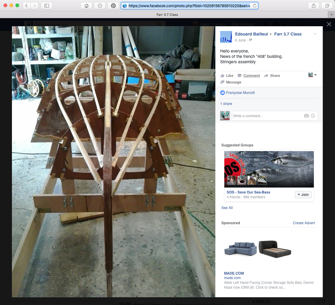

https://www.facebook.com/photo.php?fbid=10208156785610220&set=o.136529239710712&type=3&theater
