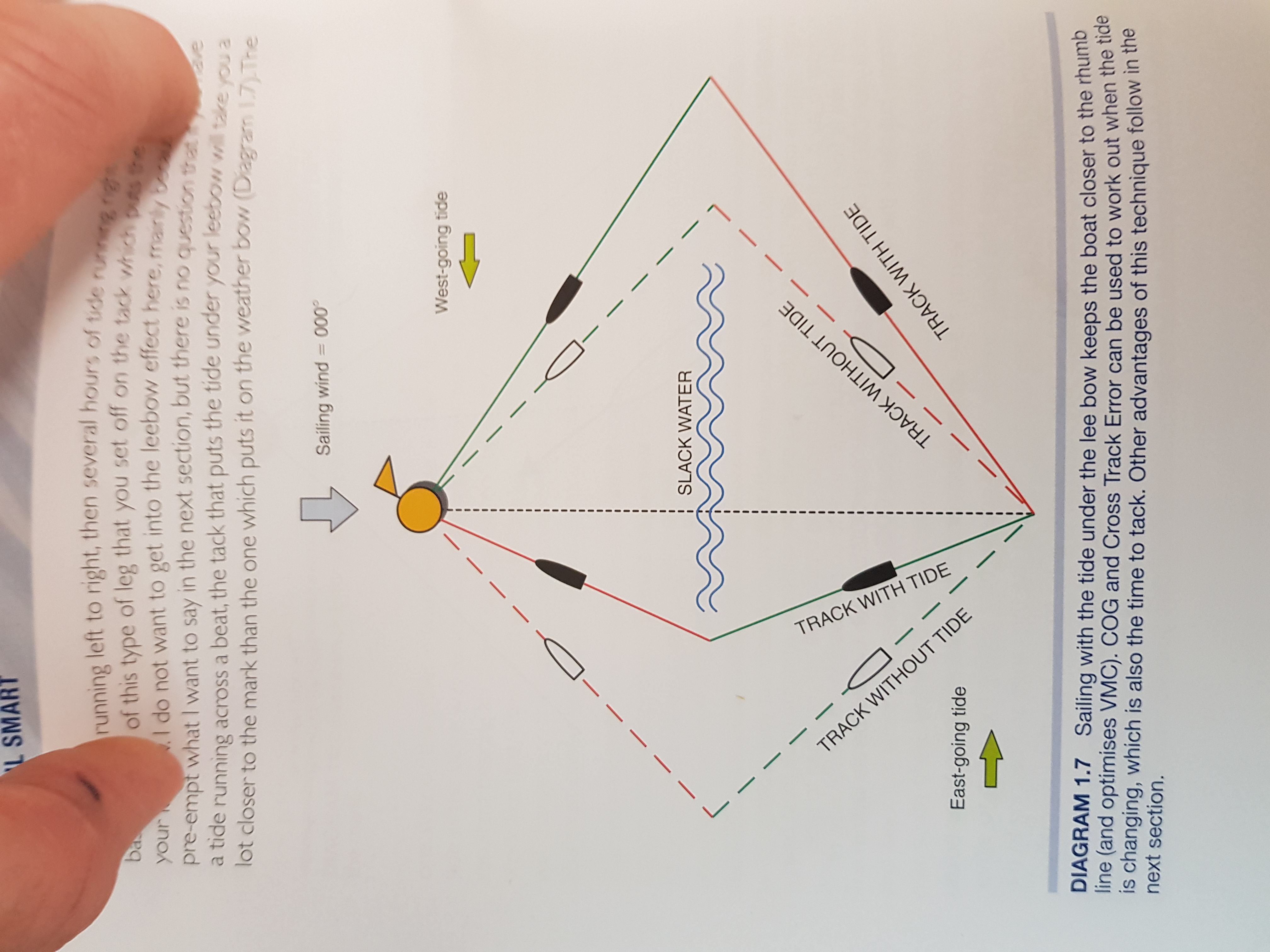

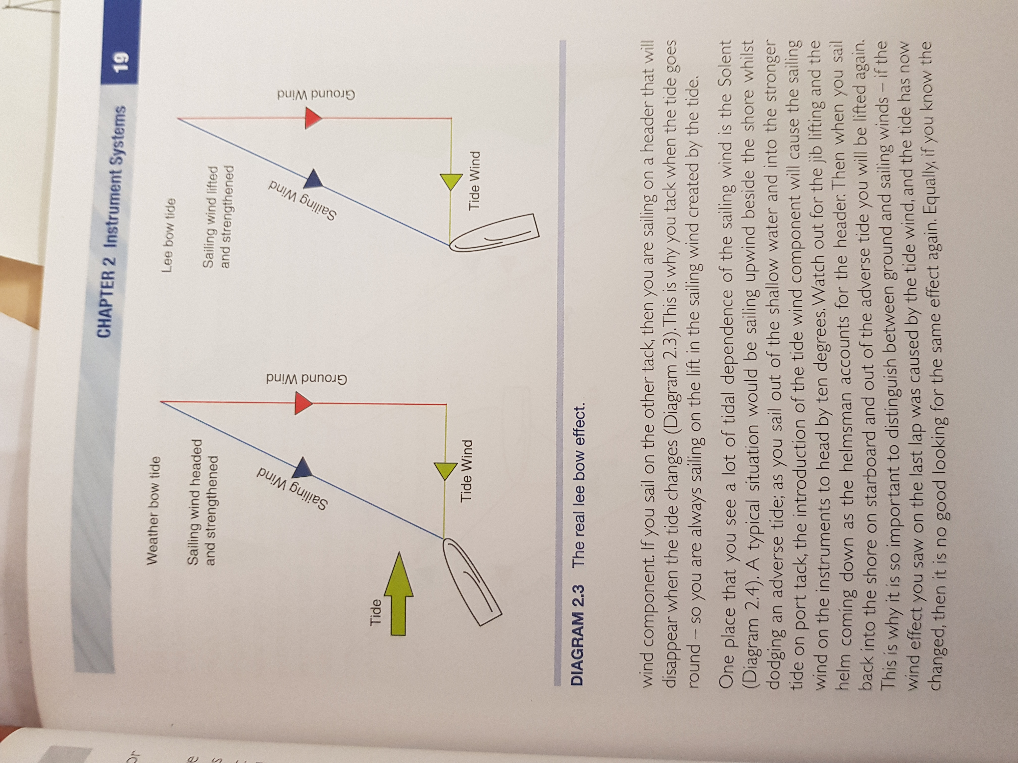

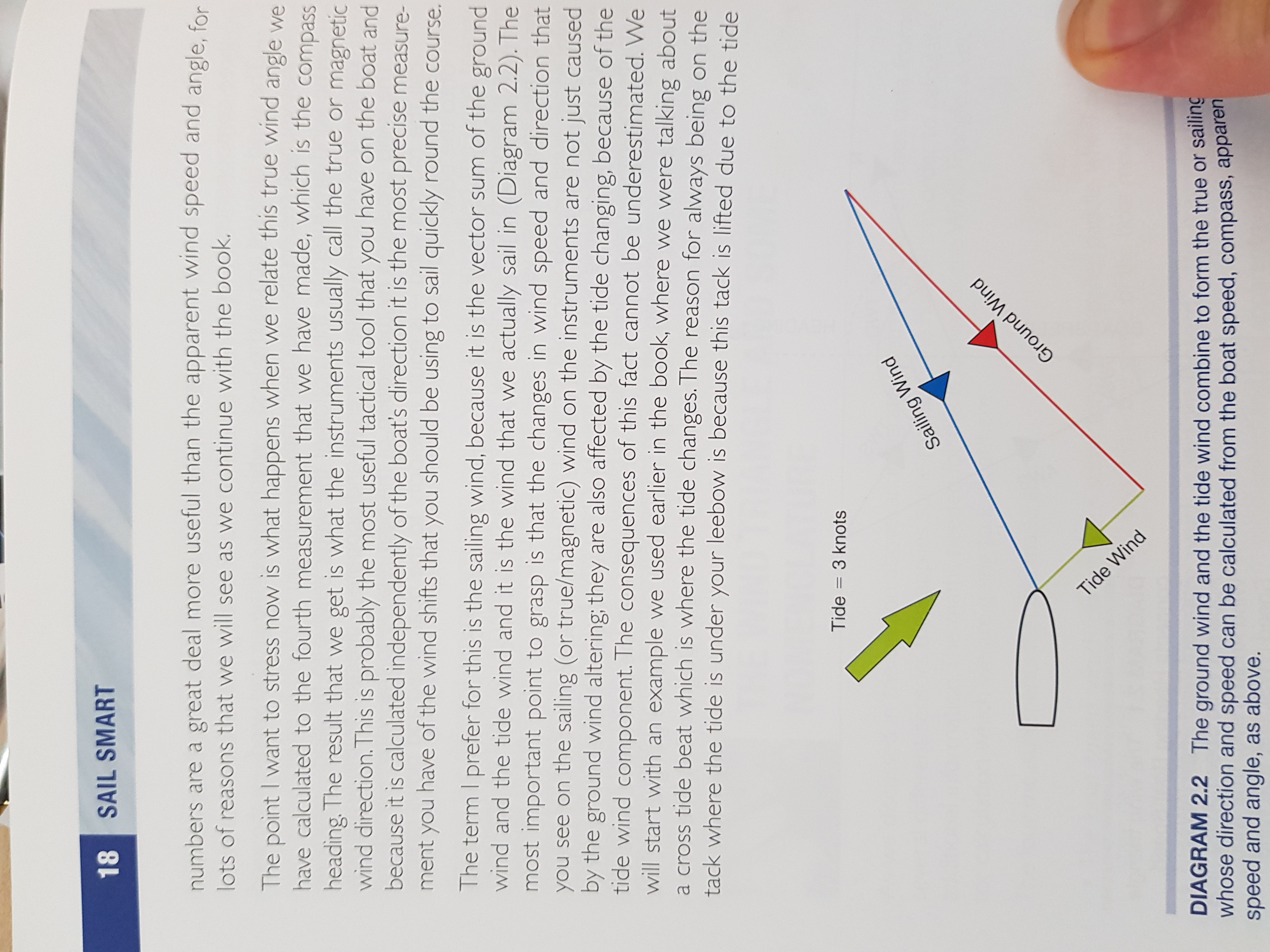

Highly recommend you read Mark Chisnell's book sail smart. How to understand what your instruments are telling you (and no I don't mean your feet)

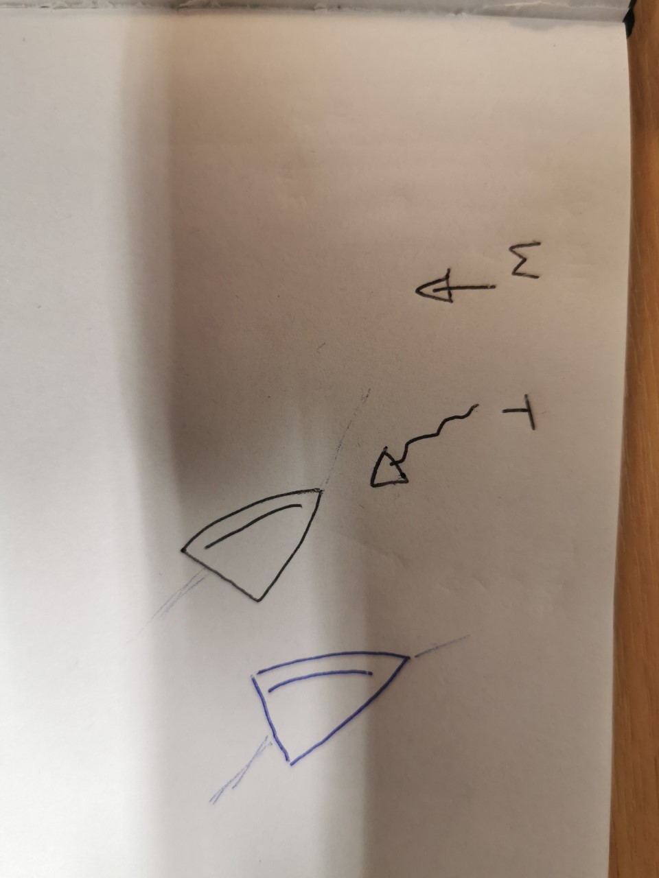

My 2p worth.... and I can see GRF's train of thought in this. I haven't looked at the maths, so could well be wrong but thinking out loud, this is what I see.
To get the tide on the lee bow without too much compromise to boat speed, etc, you have to have the PERFECT wind direction and tide direction to make it work, otherwise pinching too much will result in a drastic loss of speed and the boat will slip sideways - IT WILL LOOK LIKE YOU ARE POINTING VERY HIGH but in realist you will be sliding sideways, so negate the effect.
Rough picture below, but I think in the blue boat you will have the tide on the lee bow, which again will make you look like you are pointing really high and lifting away but the tide is still pushing you backwards and at the same angle in both boats. This pushing you back will result in less wind in the sails and although temporarily will look good compared to the other boat if NOTHING ELSE changes I would expect the black boat to have better VMG, pressure in the sails and would guess they would come out ahead in the end.
As we know, in sailing there are constant changes - Tidal gradient, tidal direction, wind shifts and pressure changes to name a few. These will likely have more of an effect over a whole beat.
