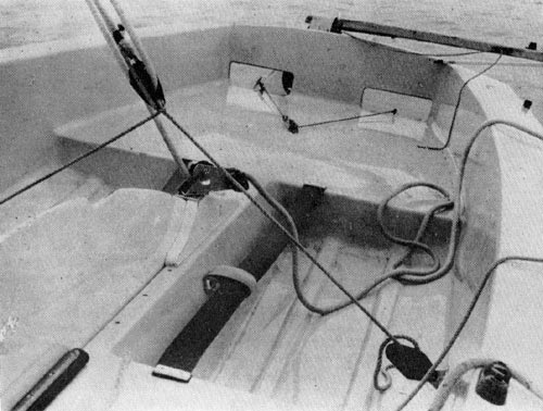

As I've just pm'd Oldarn, the best buoyancy arrangement I've ever sailed was on Jack Holt's late-'60's Jacksnipe (here's a plus for Jack then, after the crit of his Ent!).
Double floor but with self-bailer-drained footwells that lowered he crew members' c.g.'s and gave more room under the boom. The footwells soon drained, in practice.
Even that could have done with slimmer side tanks, but mine (the prototype) was so overbuilt it floated low on its side anyway!
