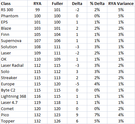

Its a bit of a circular argument, because what he's done is a regression calculation - ie an empirical formula) which aims to approximate the published RYA numbers. So by definition its a reasonable fit to the published numbers. To act as a sanity check for the RYA numbers you'd need a clean sheet VPP based on the physics, and that's quite a different challenge. What's most interesting about it, to my mind, is what the actual formula tells us. It tells us firstly that length is king, more than any other factor, even for planing dinghies, and that sail area is second by quite a way. Not a major surprise I suppose, but a lesson that can always be reinforced. Another thing it tells us is that probably most dinghies are of vaguely similar proportions - if we can gain a reasonable fit from just length, weight and sail area, its suggests that other things like overall beam, waterline beam, wetted area, prismatic coefficient etc are generally in the same sorts of proportions relative to these headline numbers - something that's been explored in some posts above. Other things that will be interesting are the exceptions - boats that are way off the straight line. They may indicate deficiencies in the formula, or they may indicate design choices - if the X is faster than predicted that may indicate a really clever design, or it may indicate a boat in which speed was a higher priority than other factors that are not measured in the formula. Similarly slower than predicted. If the Y was designed as a good solid stable boat that will carry a whole family on a picnic it will probably look slow compared to hotshot racers even for weight and length. Or they may indicate boats for which the observed performance from th PY system is way out: that's possible too. One surprise to me is that the formula came out with speed proportional to length, I'd expect square root of length, but no doubt other formulae are possible and will give interesting results too. Edited by JimC - 24 Apr 14 at 1:16pm |
It is based on the assumption that RYA PY numbers are correct. If we make the reasonable assumption that for most classes they are not too far off, then this formula may help show up where some anomalies are*, or it may be that the formula is being forced to extrapolate beyond the realms of fairness. I wouldn't expect it to work for a foiling Moth, but it should be reasonable for a Hadron.
* Unless the anomalous boat has been included in the dataset the regression was done on, in which case the formula is infected. I haven't run any race results using these numbers, but feel free to do so. The table below is a set of PY numbers calculated by the formula and compared against 2014 RYA numbers. I have divided by 10 and rounded off, because I can, and because I feel that 4 digit numbers are spurious. The delta column is the difference between the two results and the % Delta is the (absolute) percentage difference, obviously. It is usually within 1-2%, with some clear exceptions. For interest, I looked at the official RYA numbers for each class since 1981 (figures courtesy of JimC) and the last column shows how much variance there has been in the official number over those 34 years (in fact, the vast majority actually happens in the last 4 years for nearly all classes, since the system changed). You can see that variance within the RYA's own numbers is as much as the difference between the prediction and 2014 RYA numbers, so improving the accuracy of the prediction is pointless. Note that that is not the same as saying the RYA PYs are accurate to 2%. The RYA's best guess varies 2% year on year, but could still be 10% out (who knows?). ![]() |
