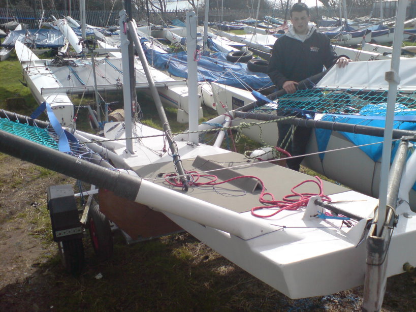

Fat Bottom Girl racing sled. Edited by s.a.l.t.y |
