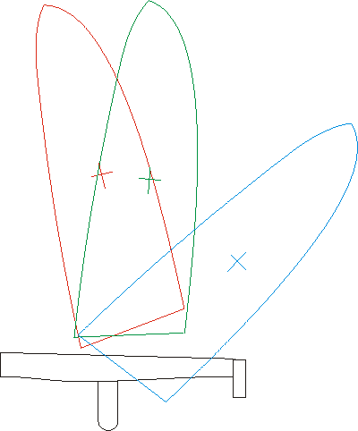

This (and it could be *****) is why I don't think weather helm is a big issue on dinghies... AIUI, and simplistically, to get weather helm the centre of effort of the sails has to be aft of the centre of lateral resistance of the foils. But the centre of lateral resistance is somewhere between rudder and centreboard. So in this pic green is a fairly normal mast position, and the side load is probably 3/4 cb, 1/4 rudder. In the red position you have lee helm, because even with 100% load on board and nothing on the rudder the sail centre is still in front of the foil. By contrast as the rig rakes back there's more and more load on the rudder and less and less on the cb, but you won't get weather helm until the rig is raked right back to the blue position so the centre of effort is aft of the rudder (or if the side load on the rudder gets so great the blade just stalls out).
In the days of yachts with no separate rudder then the centre of lateral resistance was effectively fixed, and so weather or lee helm was much more likely, and I suspect even with modern yachts the rudders are so small in proportion that the clr doesn't move very far...
But this is lunchbreak theorising - certainly very over simplistic and possibly even nonsense!

You just drew a windsurfer rig!
A windsurfer with board is a good example for  explaing this. Not least as it effectively has a Rudder (Skeg) thats fixed on the centreline.  Old style teaching for windsurfers told them to steer by canting the rig. And sure enough if you lent the rig forward it bore away, lean it way back and it luffed. There was a balance point for straight on, and anywhere else produced a luff or bear away - albeit relative to the angle of inclination. A slight difference in inclination from the 'balance' (which is all that is available to most dinghies) made very, very little difference, and was more than cancelled out by other factors such as the fore/aft trim, angle of 'heel', sail trim etc etc.
