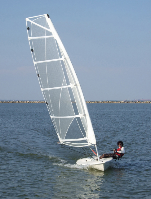

I didn't say they were conning anyone, I simply think that it's a big claim to say that laminate films don't work on bendy carbon rigs... especially when citing windsurfing as the innovation driver. The only soft sails I've seen on windsurf boards have been on very basic beginner/kid equipment or stand-up paddle boards- neither of which I'd even vaguely associate with performance orientation. And as others have highlighted, laminate sails appear on plenty of flexible rigged unstayed unarigs- the Finn, D-One, OK being obvious examples, with the 'rumoured film sail' for the Laser and the Hansen Laser turbo kit being another. There would be a sense of major irony, if by taking a chunk of Laser market share (enough for baby fingers to notice anyway), this accelerates the acceptance of some kind of laminate/carbon top section relaunch. Then ask yourself if the average punter (or the IOC) which one looks more modern and accessible- the 3 separate dacron-based new classes under the Aero programme, or the Laser with a nominal performance upgrade for sub $1000 in 'real terms': ![]() Edited by yellowwelly - 04 Mar 14 at 9:16am |
