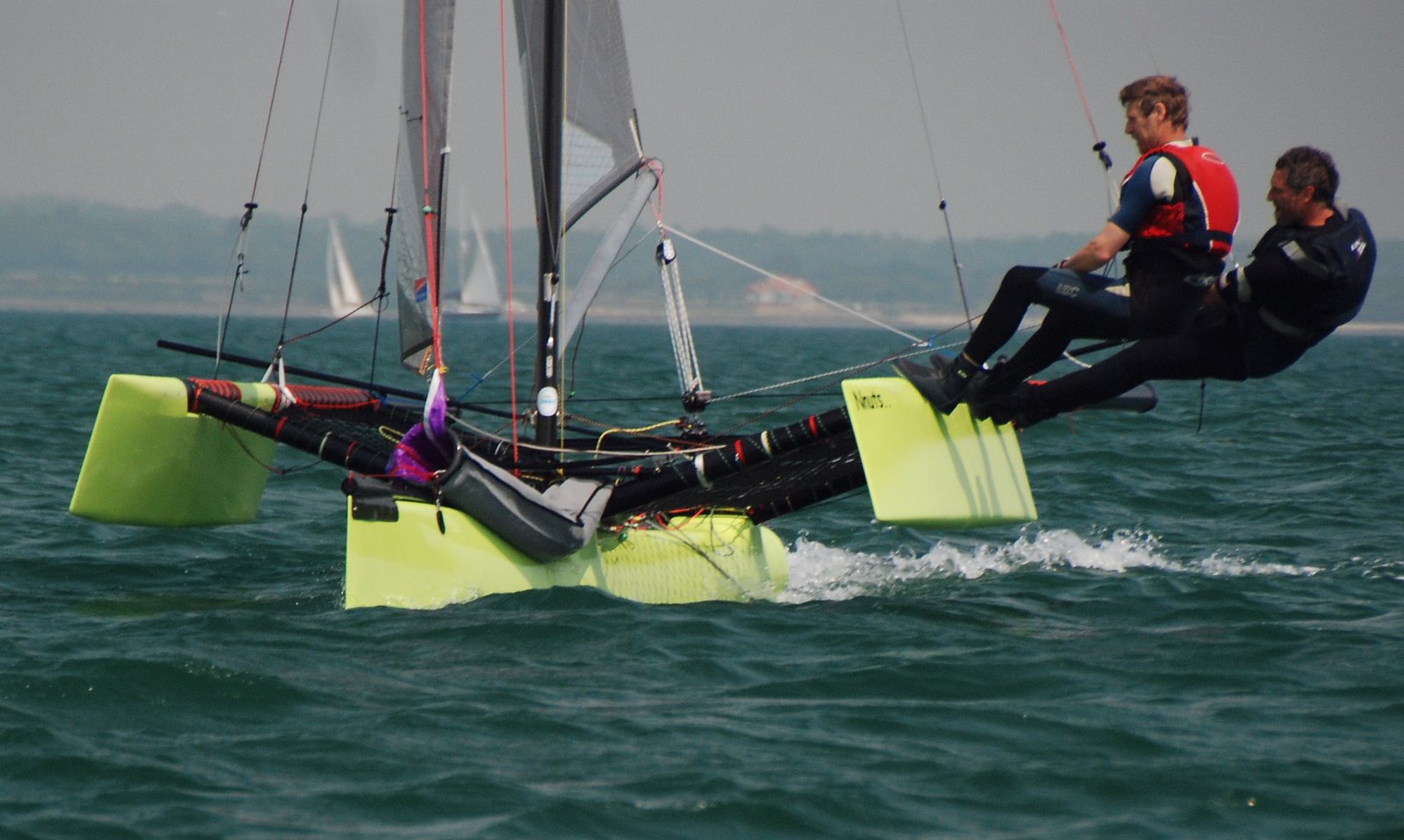

It will be hard to build something like that to any decent weight. I still think that if you are keen on the multihull style you have three real options outside traditional cats. 1. pickup a cheap Vortex - it gives you stable trapeezing or if you want to bast***dise it further get some aluminium and netting bench seats off a hobie and fit them either side. 2. buy a weta! 3. build something like the 'tri fly' we have. I posted photos ages ago, but can't find them. Basically a buoyant thin central hull with racks coming off either side at big angles and small, shorter hulls on either side outboard of the racks. Very quick and the guys who built it call it a stabilised monohull. |
Here you go:-
Edited by SimonW99 - 05 Dec 14 at 8:50pm |
