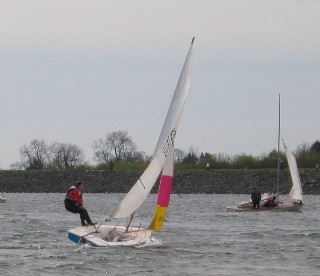

Looks like we've done similar mods. Looped sheets & extendable tiller extension certainly help. I'd like to get the sail controls back to the helm - but it needs a spider web of rope or blocks expensively and damagingly screwed all over the hull. A compromise is to tie the (now 6:1) kicker line to the trap hooks, contender style (you could knot yours to the main sheet). Outhaul I haven't sorted except to run it through a block tied to the mast and then back along the boom to an elastic - can be adjusted while unhooked during a tack - just about. The cunningham I rarely use anyway. I have yet to try running the main sheet straight off the boom, like a 29er - but it does have advantages. May try your trap hook position tweak, though on the L2 the best single handed position is pretty far forwards - which, unlike the Buzz is about the only place you can easily step out. As you say - most fun around F4. F5-6 and my 12stone struggles to keep it flat, or even upright (straight legs & back might help!!) Keep up the good work and you may convince me to trade up to a Buzz. |

that looks fun!!!

More panic-struck than boring. Rather be on the edge than crewing a tub - but if anyone wants a crew for their RS800 or twin wire cherub .......... |

Well done NickA, You're the first to get pics of singlehanding a 2-up on the wire here. Do you ever have a go with the kite? I sail with the Buzz kite loads on my own (simple to hoist and drop), but I've only used it on the trapeze twice (both in very steady force 3 on the sea). The Buzz has 17.4 square metres of spinnaker, but as its assymetric it behaves kinder across the wind than a symmetric spin. On the plane everything becomes more stable, just lots of blasting.
