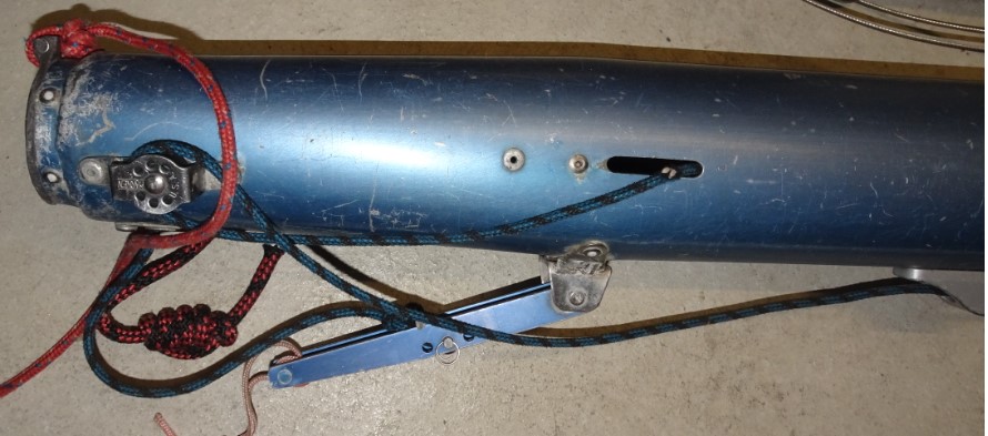

This week-end we had the mast up the first time... Boom The boom we bought separatey somehow has got two outhaul mechanisms we do not fully understand. One features a kind of lever at the front end of the boom. Maybe "Coarse" and "fine" control??? (In German we would call it "dead center lever", whatever that is in English...) Does anyone have an idea how this may have worked? The vang already has got continuous control lines led to the transom, unfortunately the cleats "disappeared" at the previous owner... Rigg We reduced the 4 trapezes to only 2, the 3rd wire will serve as temporary forestay in the future. Neither the jib nor the rigg came with a forestay, so the jib seems to be from a different i14 and features a zipper on the luff. We tried 4 mm Dynema but I suspect that a wire would be better to "forward" the rotations of the roller drum up the luff if that makes any sense. The shroud tension control stuff will go away. I would like to remove the uppers together with the purchase and control lines as well, but SWMBO has not yet agreed to move the kite halyard block from the top of the mast to about forestay height yet... Another thing I do not fully understand is why this rigg needs lowers. As the gooseneck is not far above the spaceframe and the mastfoot is level with the space frame (i.e. not on the cockpit floor as it was common back then), there is not a lot of "lever" for the boom to bend the mast/the mast is fixed on space frame level anyway. Any thoughts on this? Other Fittings The kite sheet ratched blocks and the halyard cleat "disappeared" as well... There are many turning blocks distributed through the whole lengths of the boat, presumably related to the fact that kite sock and boom reach so much further back into the cockpit than in most other dinghies. We are trying to understand the layout by looking at old pictures of another (however well sorted) Ovington Howlett 1 B. Main We tried our RS Feva-main. It kind of works at least ashore but there is a lot of excess height/length of mast/boom left :-). Edited by skslr - 19 Apr 21 at 10:03am |

Front end of boom:

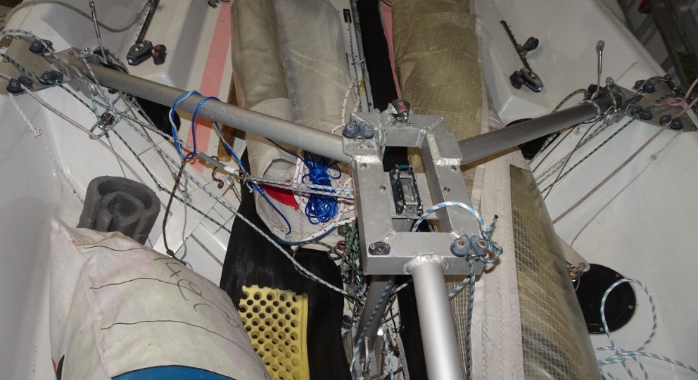

Spaceframe with "mast stump":
Was a Selden boom with course and fine adjustment, not sure of the benefit, we had multi purchase inside of the boom onto a single cleat and turning block, since there was plenty to keep you busy rather than fiddle with the mainsail foot
