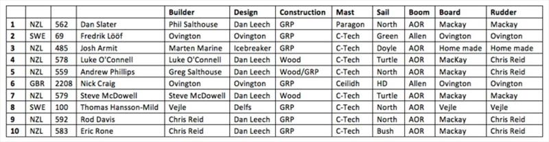

Jim it is indeed the case that wood boats are as fast as foam sandwich ones in the OK. It is probably for all the reasons above but it is encouraging to see that this is a possible route again now we are all supposed to be more careful about sustainability etc. The table below is from the last Worlds in early 2019 taken from (https://www.yachtsandyachting.com/news/215612/Individualistic-choice-of-OK-Dinghy-Equipment). The article also sys that only four of the top ten were production boats, the rest being either home built, or built using Dan Leech's CNC kitset plans by professional builders and the third placed boat in Auckland was 35-years old Icebreaker. ![]() |
