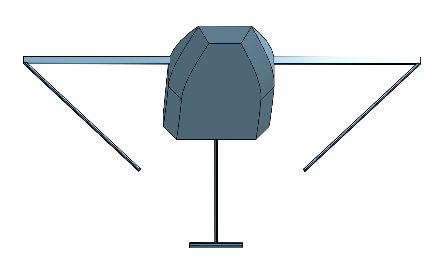

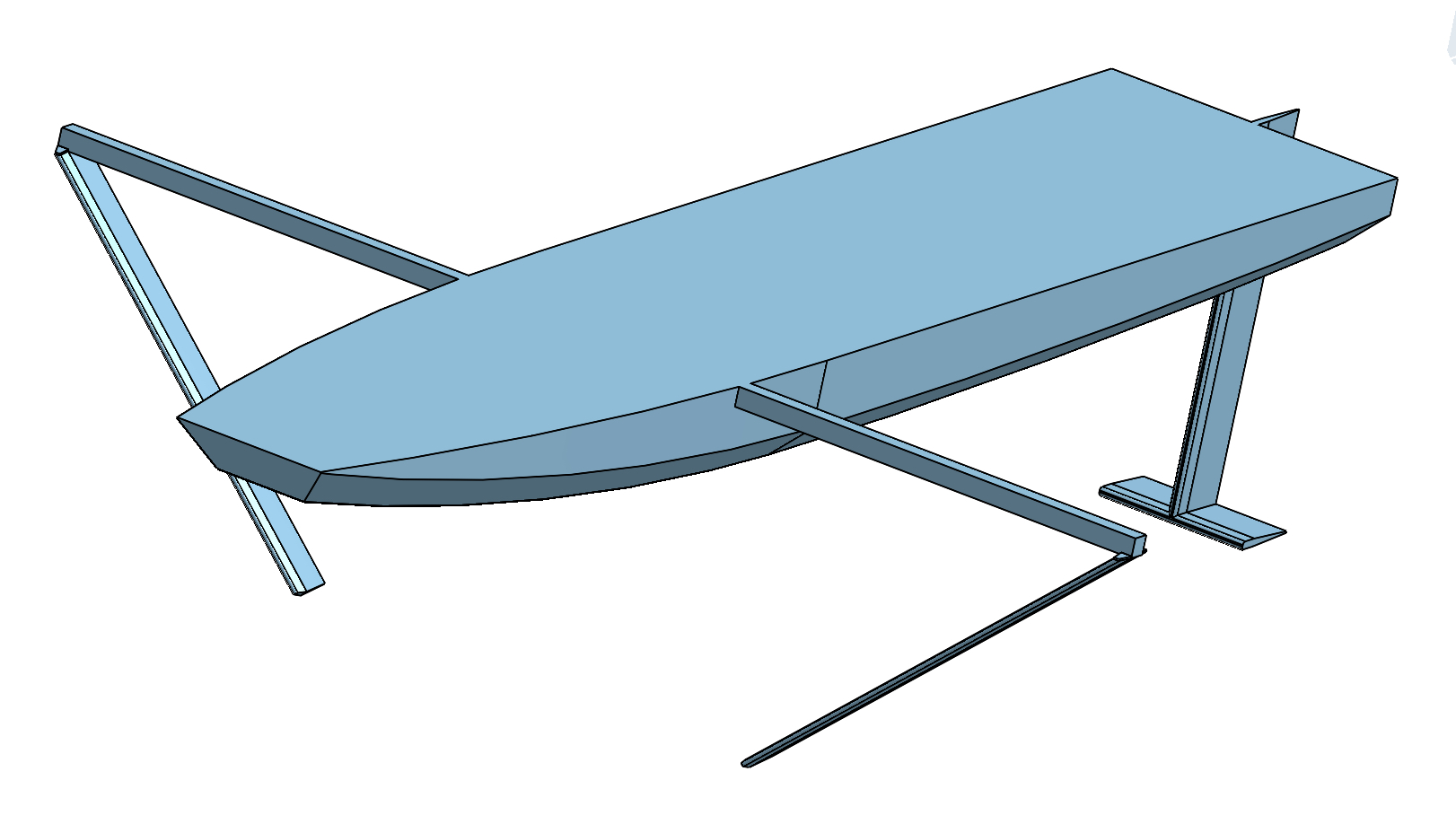

Post Options Post Options   Quote tink Quote  Post ReplyReply Direct Link To This Post Posted: 20 Oct 19 at 6:09am
VERY VERY basic sketch but, just showing the configuration.
Trapeze so can quickly adjust trim
Edited by tink - 20 Oct 19 at 6:10am

Post Options Post Options   Quote bdu98252 Quote  Post ReplyReply Direct Link To This Post Posted: 21 Oct 19 at 10:06am
In a sailing dinghy you need the foils to resist side loading if you want to go upwind with any efficiency. In this case if the boat is flat both sides are cancelling each other out which is fine for a power boat but not for a dinghy. If you heel it to windward then the leeward foil provides the side force and the windward one provides the lift. Given that this reduces the righting moment from the crew this is not a fast look. Also this is why the RS600 foiler did not work too well in that trapezing off a boat heeled to windward is not to easy or comfortable. Back to the drawing board I think.

Post Options Post Options   Quote tink Quote  Post ReplyReply Direct Link To This Post Posted: 21 Oct 19 at 5:48pm
This configuration was used on many record breaking craft from the 1950s until the recent past. The windward foil is naturally immersed more and a vertical portion on the foil tip is sometimes added. I simply presented a very simple configuration that is well proven and simple - which was my reading of the OP ‘ easier to sail platform like the Skeeter would make the boat more accessible to more 'normal' sailors‘

Post Options Post Options   Quote tink Quote  Post ReplyReply Direct Link To This Post Posted: 21 Oct 19 at 6:37pm
Not fully upwind but I think in illustrates my point

Post Options Post Options   Quote john80 Quote  Post ReplyReply Direct Link To This Post Posted: 22 Oct 19 at 7:05pm
It is on a catamaran which makes quite a lot of difference. There is a reason a moth looks the way it does.

Post Options Post Options   Quote tink Quote  Post ReplyReply Direct Link To This Post Posted: 22 Oct 19 at 7:52pm
And costs as much as it does, I am just pointing out that there are other solutions other than wands and incidence control. One of the first foiling moths used this system. Yes they went a different direction but that could have been driven by fitting the concept into the class rules rather than the system.
