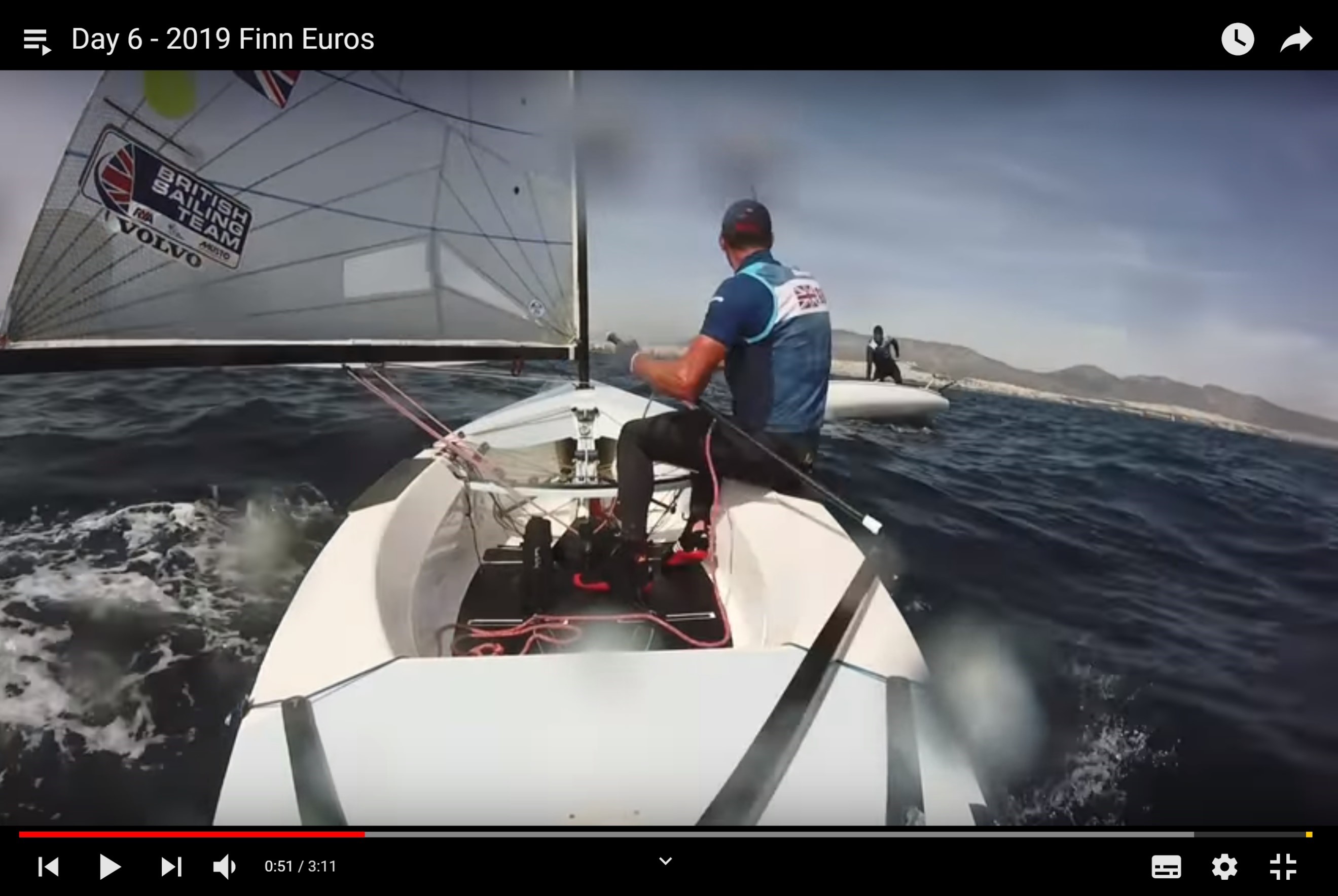

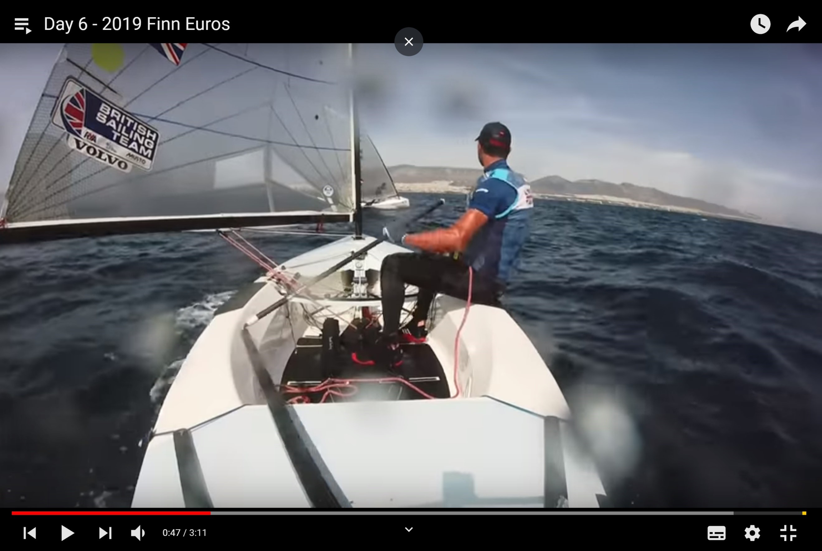

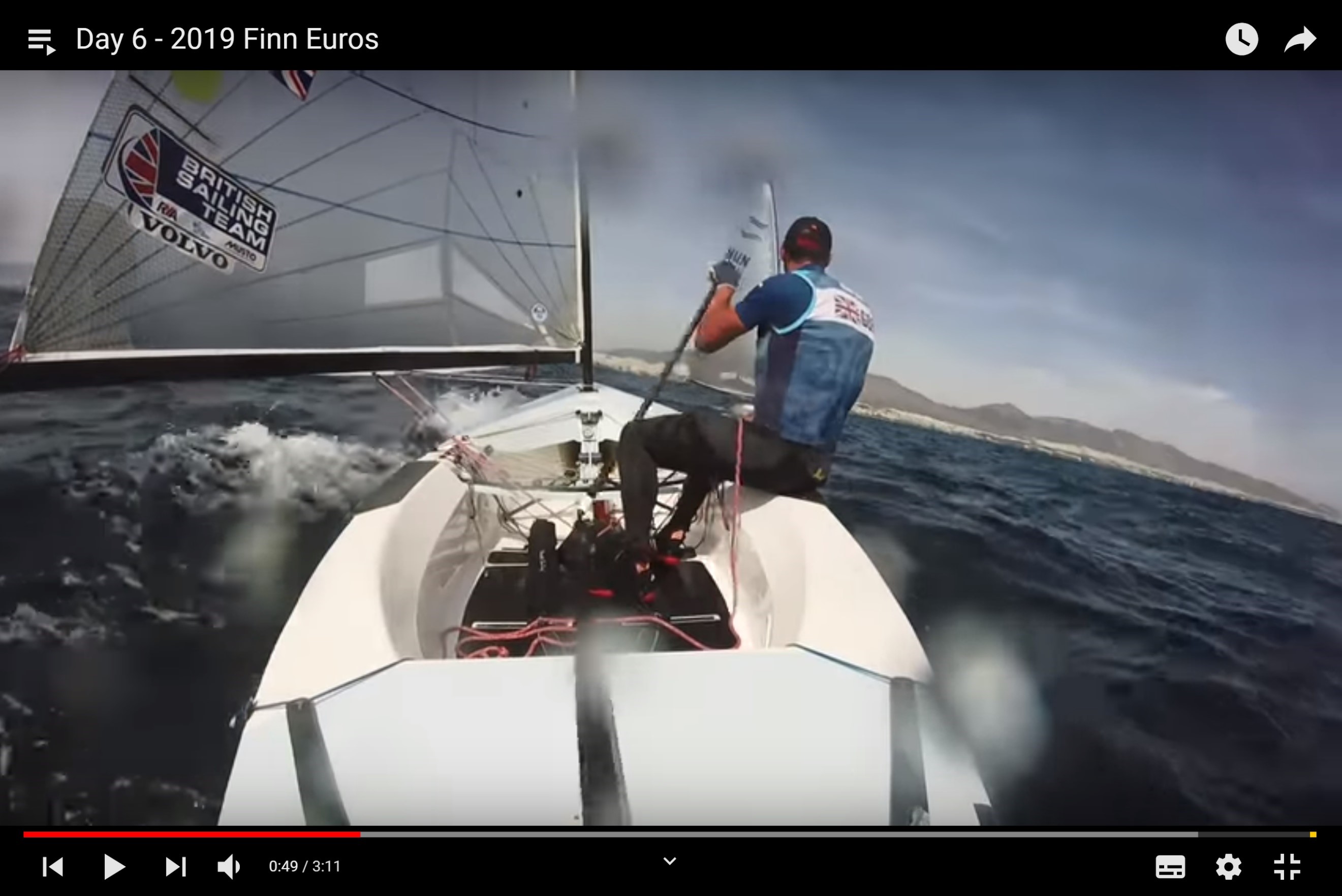

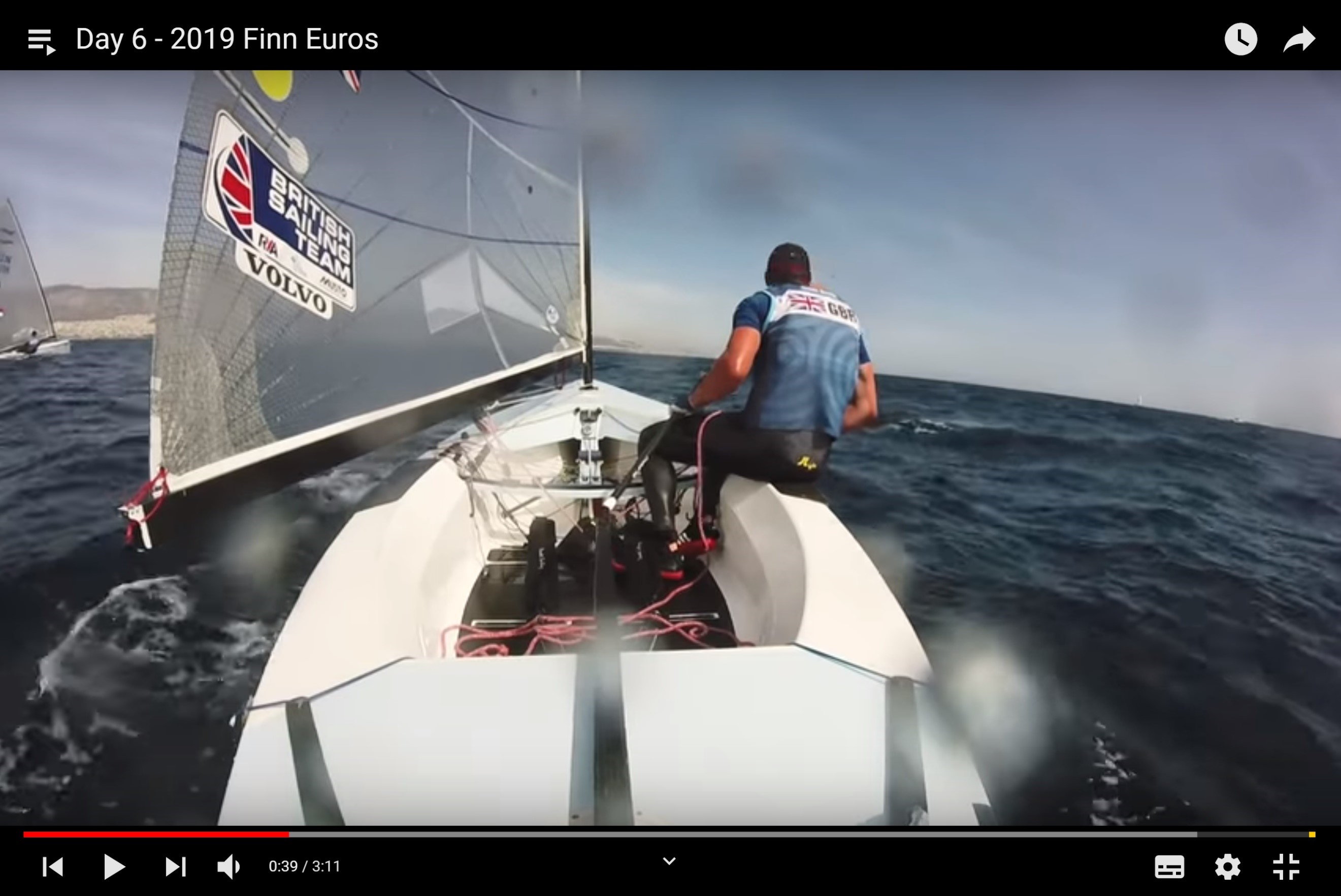

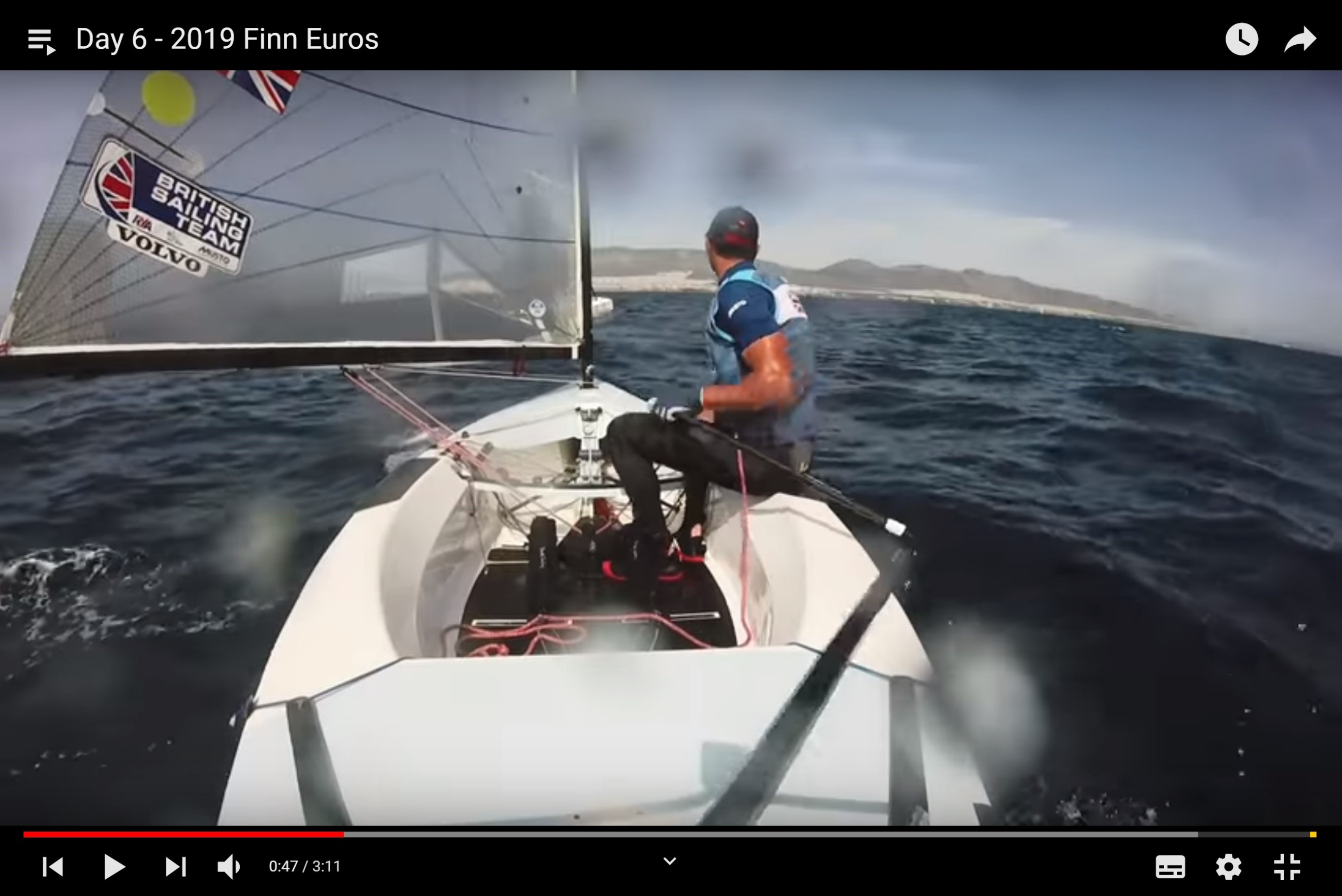

To be honest I thought the purpose of 16.2 was to prevent tactics such as these. Giles seems to change course a few times. I think the first bear away is just about okay, but at 50 seconds the Hungarian bears away further still to pass behind, at which point Giles almost immediately alters his course as well to bear away further. Maybe Giles forgot he wasn't team racing? I think he was lucky to get away with that.

Far as I can tell from the video, Giles alters course twice.
The first time as soon as the port boat tacks, when they are still a considerable distance apart, so no rule breach there. Then the port boat alters course to duck and Giles bears away again to a new course. After this the port boat appears to hold course for 2 seconds before heading up to avoid a collision, which seems to be a bit longer than "immediately".

38 seconds "16.2 In addition, when after the starting signal a port-tack boat is keeping clear by sailing to pass astern of a starboard-tack boat, the starboard-tack boat shall not change course if as a result the port-tack boat would immediately need to change course to continue keeping clear." I'm not sure the other boat is ever sailing to pass astern because Giles drops the bow so early. So it forces the other boat to either try and cross, which is unlikely as Giles would come up, or tack back. Which is what Giles is saying to the umpire the boat should have done. ![]() ![]() ![]() ![]() ![]() Edited by mozzy - 03 Jun 19 at 12:32pm |

Giles Scott incident: As per earlier analysis, 16.1 seems unlikely to be broken if the port boat was able to avoid a collision. So it's just down to 16.2, and I would say that for the Starboard boat to be at fault two facts would need to be found: 1. At the point starboard altered course was P sailing to pass astern of her? In this instance if S altered course as soon as P tacked onto port it would seem hard to conclude she was at that point doing so. 2. That P had to take immediate avoiding action following S's course change. Even a half second delay before P responds would seem to be sufficient to put this in S's favour. It would seem that as long as S acts early and positively then it should be possible for them to prevent P from ever getting into a position where 16.2 applies, and 16.1 has no "immediately" clause that she needs to comply with - if P is able to keep clear by acting immediately then she must.
