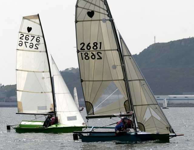

But a cherub with narrow transom, and chines very much tapering in like this P7 ( multi nationals winner )
is very stable at speed ( and only falls over when going slow or round the corners). The tapering in also helps reduce wetted surface in light stuff, without having to sit on the foredeck.
but you do still have to sit fwds ( here's two P7s in light winds)
