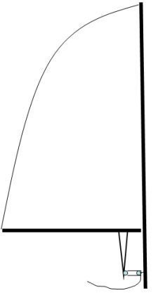

I couldn't find a photo, but sort of like this:
JimC
Posted: 16 Jul 10 at 10:19am |
I've never been totally convinced about those...I have trouble working out in my head why they should be better than having an ordinary kicker anchored to the same point, which ought to be a bit lighter. You'd still have to reinforce the boom, but maybe not as much...

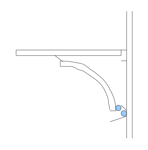

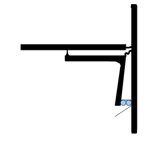

Wouldn't a carbon Kevlar boomerang kicker work, mount it
to the normal places and give you the same power and flexibility but remove the killer diagonal line between boom and mast [edit] can't upload my sketch thanks to the crap software this forum uses and chrome browser, the only browser on this linux workstation
[edit2] installed Opera to see if that'll work! woo hoo it does!
Edited by Norbert |

Posted: 16 Jul 10 at 1:13pm |
I would guess this is effected by the acuteness of the boomerang angle. If it were less say as an arc deflecting merely 9 inches this will give a lot more space for the crew and a whole lot less stress on the structural intergrity... ![]() Edited by Norbert |
