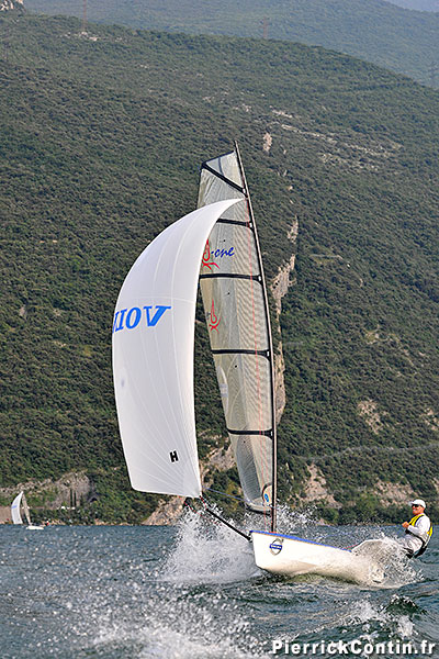

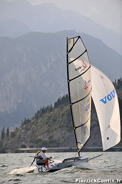

Latest photos of Devoti one, looks great. a few control lines look like they need cutting to the right lengths like the one on the tack of the kite, but nice looking sails that fit the mast. looks like Luca has improved it from the prototype I sailed with all his testing in Hyeres and Garda. http://www.pierrickcontin.com/actu.php?portfolio=176&deb ut_0=0&debut_1=0 contact Rodny Cobb if you want a test sail http://www.suntouched.co.uk/devoti-one_suntouched2.htm
Have the wings grown Sten? |
shame there's a touch of the MX-Ray about that rig...
![]() ![]() sorry it is still the ugly love child of a MX-Ray / Fin / laser EPS styled by someone still stuck in the 70's. Blue decks, off centerline pole. The concept might be great, it may even sail well, but heavens take the thing to a decent product design studio to make it somewhere near this century. |
Mainsails look a lot better to me. Materials and panel layout suggest Hydes - any unstayed mast will look a little strange when powered up with the kite, but I reckon they're decently stiff unlike the MX ray, and this will go upwind, unlike the MX ray. Racks look like they've been set a little higher if anything, strange despite the boats, ahem, comfortable freeboard. The booms / main foot looks to have been cut a little higher to suit. Nice set of photos though. Decent breeze and evening sunshine on Torbole, shorts, tshirts and bare feet. Luca knows how to put on a show for hs mates! |
