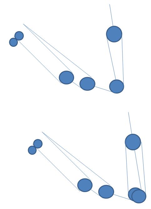

    Posted: 16 Jan 12 at 1:19pm
You get high load or wire blocks for the business end, then you can downsize once you're into the cascade.
while i'm out of the loop  these days this is what  people always used to do
wire 2 or 3 :1  that the shroud clips to then lead to a cascade / 6:1 tackle or  muscle box.
Pictures? Link? Don't see them on the wall of my local dinghy store..
A high load block on the end of the shrouds would make it easy to thread a lead through just to get the wire in place so I can then attach the forestay.

Post Options Post Options   Quote Lukepiewalker Quote  Post ReplyReply Direct Link To This Post Posted: 16 Jan 12 at 4:17pm
http://www.pinbax.com/index.asp?selection=category&cg=7&mc=67&cct=4&TypeSearch=
Nowadays we tend to use 12 strand dyneema/spectra or vectran for the bit that used to be wire.

Post Options Post Options   Quote Lukepiewalker Quote  Post ReplyReply Direct Link To This Post Posted: 16 Jan 12 at 4:48pm
Shrouds
Ex-Finn GBR533 "Pie Hard"
Lukepiewalker View Drop Down
Joined: 24 May 06
Posts: 1341
Post Options Post Options   Quote Lukepiewalker Quote  Post ReplyReply Direct Link To This Post Posted: 16 Jan 12 at 4:51pm
Hopefully those make sense. A lot of boats use through deck blocks for the shrouds but based on the picture you showed us it doesn't look like an option. You can increase the purchase by adding another block to the cascade.

ER thank you Mr Piewalker think I have an idea forming now...
