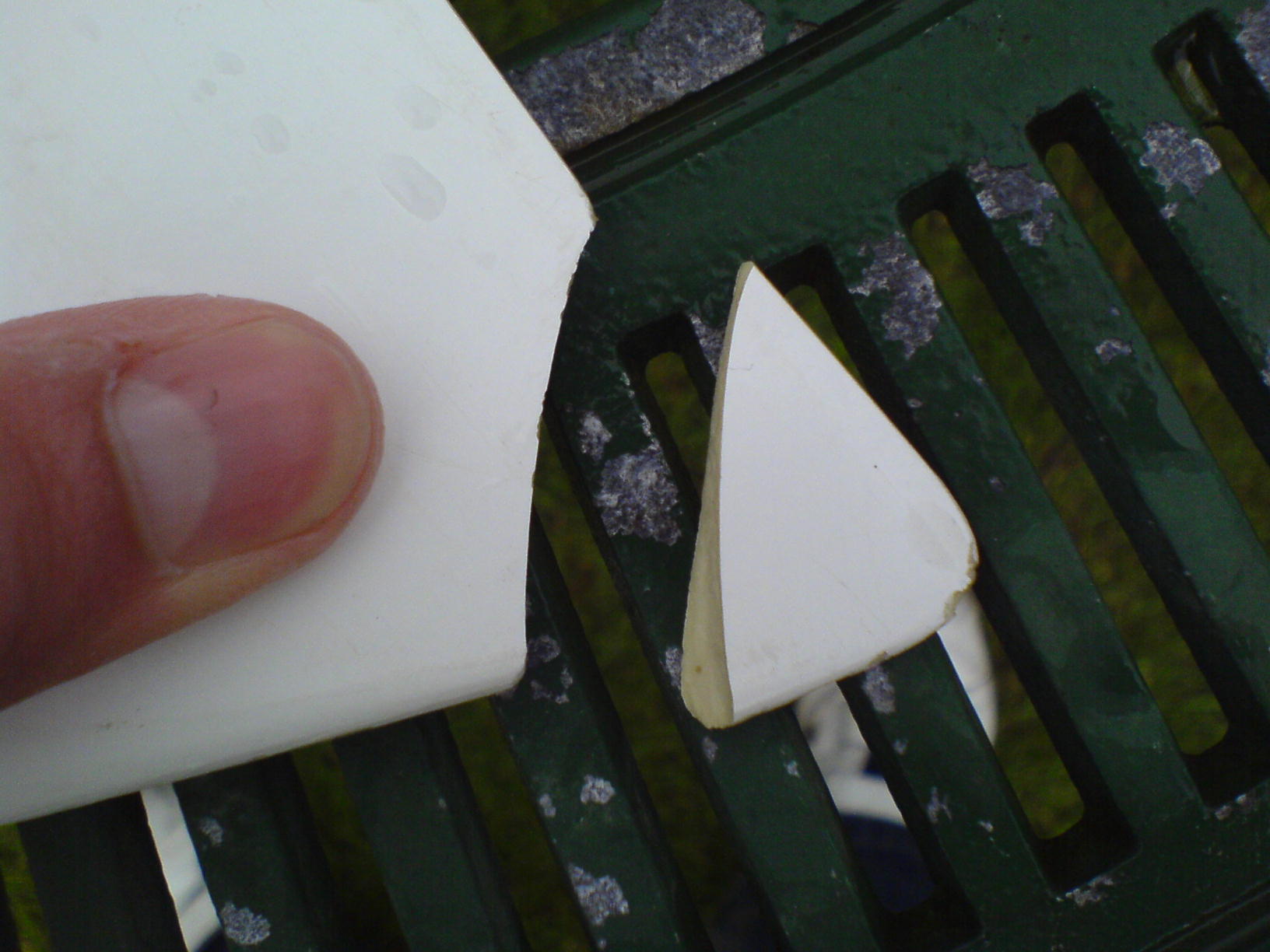

Thanks for all the advice i think im going to put two short metal rods one running parallel with the trailing edge and the another with the bottom of the board. Epoxy them in and epoxy the chunk to the main part of the board.

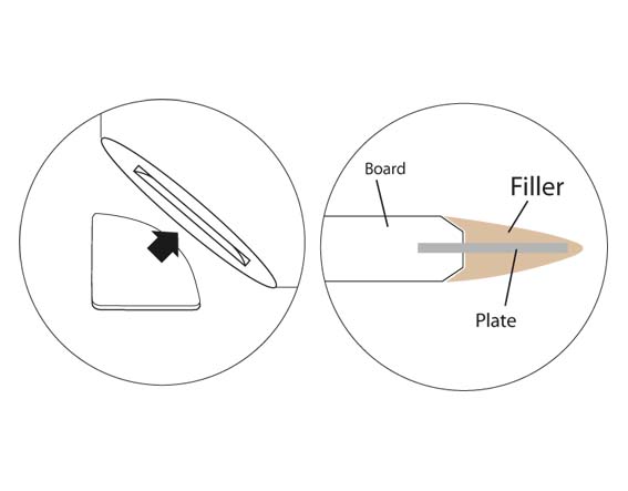

I may be better to try and make a 'biscuit cut' as you won't have much board for a screw. You can use small nails but this has been unsatifactory for me.
You'll need a small rotary blade. Fair the tip back to square. Cut the slot with the rotary blade. Stick in the plate ( either a bit of laminate glass or metal plate ). Let that go off. Sand back the 90 degree edge you have stuck the plate into so there is more contact area for the filler. You can even dill some holes in the plate for a better mechanical key fi you want. And then fill and fair. Finish with some spray paint if yoy feel like it. ![]() |
I'm suprised you haven't bled to death by now, I'd get down the hospital ASAP. Put the end of your thumb I can see in the picture inside tuperware box on top of a bag of frozen peas that should keep it fresh until the doctors can sew it back on! |
