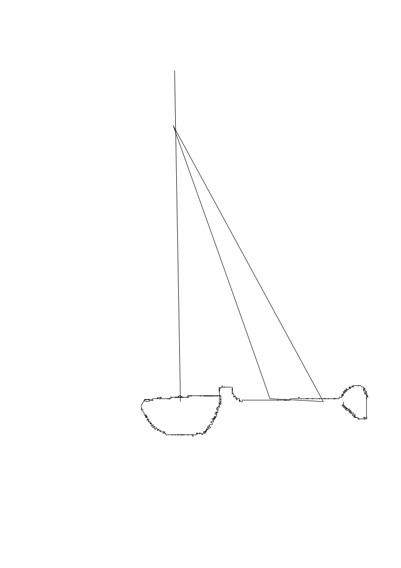

In terms of the physics, what this all boils down to is a single mass (comprised of boat, rig and sailor) which are all fixed in relation to one another, once the sailor is on the wire.
This mass has a centre of buoyancy, typically somewhere between the centre line and the leeward chine, and a centre of gravity which is typically somewhere to windward of the hull for a trapeze boat.
The righting moment is the difference between those two. How the sailor is attached to the boat has no effect whatsoever on this equation, whether they are hanging on a wire or sitting on a rack or a sliding seat. All this affects is how the forces are resolved within the boat, the righting moment is dictated simply by the how far away from the centre line their weight is.
Looking at the trapeze system in more detail, if the wire is hooked on to the sailor higher up their body this will increase the tension in the wire as it is now supporting the same mass but with a greater horizontal component. This is balanced by an increased force acting inwards via the sailor's feet pressing on the gunwhale, but again this is purely all about resolving the static forces within the boat and has no effect on the overall righting moment.
So yes it will feel different, and indeed it is quite intuitive to grasp that the more vertical the wire the more you are hanging from it, whereas when the wire becomes more horizontal there is more force trying to pull you back into the boat. But once all these forces are resolved the righting moment is the same

The position of the hook/trapeze wire makes no difference to righting moment, but it makes all the difference in the world to the loads on the gear, the ability of the sailor to move in tune with the boat and the effect on the mast bend. So the intuition that its crucial is correct, but the reasoning as to why is wrong.
