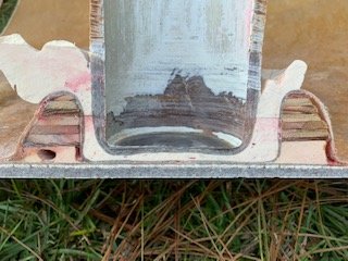

I presume that over the past 50 years we have gained about 5kg. Someone in the 75 to 80kg range kind of falls between the big and small rig of the Aero and D-Zero so Laser a better choice. There are plenty of Lasers out there so economic to get a competitive boat and eventually people upgrade, if you have sailed something for years you’re likely to stay in the same class, go up the chain and people buy new boats. Back to the build quality this is the mast foot |

Riv ![]() Far too distracted from work ![]() Joined: 23 Nov 13 Location: South Devon Online Status: Offline Posts: 353 |
Wow, that is a lot of tolerance in the fit between the mast pot and the step. I assume it was designed like that initially to make it really easy to fit the deck and hull together. Maybe some hull and deck moulds needed this much tolerance to fit because they were built to a wide tolerance in the first place. There now is absolutely no need for this much tolerance. If they are all like this then I'm not suprised mast rake is a problem. It's a shame old Lasers don't get sawn up much as this would have been sorted out years ago.
