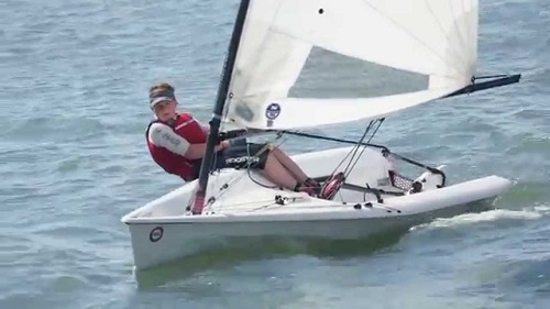

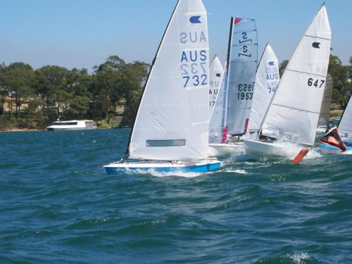

And do you really think raising the boom to make the boat accessible to old men and novices while sacrificing efficiency to induced drag is progress?
What makes you think that having an 18inch gap under the boom is significantly better than having a 30 inch one?
I like Dan's point about lowering the centre of effort more than my observation about induced drag, but I can't accept your reasoning, Jim.
No way that's an 18" inch gap between the bottom of the boom and the deck at the mast (where it matters most, as you know); more like 5" or 6".  And there's a deck flush with the gunwales beneath the boom.  Whereas on the Aero:
Put it another way, if you were running a wind tunnel test with the foils with those sorts of ratios of gap to floor:span, would you be happy there was no end-plate effect in either case?  I'd say there would be an effect with both rigs, but considerably more with the OK.  Marchaj recorded a 10% improvement in L/D by moving a Finn sail from 10" to 6" above the floor.

But how much of that 10 % is theoretical, and how much is real when sailing in all the ever changing conditions that happen in a race? Also what percentage is the increased drag of a higher boom in the total drag of the boat and sailor? And if an average sailor is more comfortable and quicker though the tack with a boat with a higher boom does this also out way the theoretical advantage?It's like bikes, a manufacturer will tell you it's new bike is 10 % more aerodynamic, but a bike is less than 1 % of the total drag of the bike and rider. So what do good riders do, go in a wind tunnel and get tested and this is where it gets messy. His best aerodynamic position, might not be fastest on the road, because it's too uncomfortable. Most of these things are a compromise.

I think the end plate effect between the boom and deck is limited. It may look worth while in a wind tunnel, but in the real world, its acknowledged that there's not a great deal of wind between the water level and 1 metre above it. So unless you've got a metre of freeboard its probably better to give yourself a bit more room beneath the boom for ease of handling.

How come my hat always gets blown off then?
Accept wind gradient in the light stuff but it scrubs sown to sea pretty well in any breeze else you wouldn't be able to see it on the water.

Good point about the hat, Dan, mine does too! And of course it's in windy weather that L/D becomes most important, when you want max. thrust/heeling moment.
Blue One, I share your scepticism about manufacturers bike tests. Results depend on how they weight yaw, the wheels they fit and whether the dummy's legs are pedalling. Nonetheless, measurable improvements have been made, meaning you cover a set distance faster and/or use less energy, so an aero frame is handy if you have a flat stage.
Likewise I'm sceptical about claims made for small-area, high aspect boards in, say, the 505 class. There are so many other, major contributors to drag upwind - hull hydrodynamic and aero - and high-aspect foils stall more easily. Nonetheless, I'd be loath to risk turning up at a 5-oh worlds with a large area, low aspect board.
That 10% gain was experimentally measured, not merely theoretical, and the difference between Aero and OK is greater than that. We've had testimony from two people that the OK has plenty of room under the boom, too, so I find it hard to see any advance in the Aero rig over that of the OK, quite the contrary in fact.
