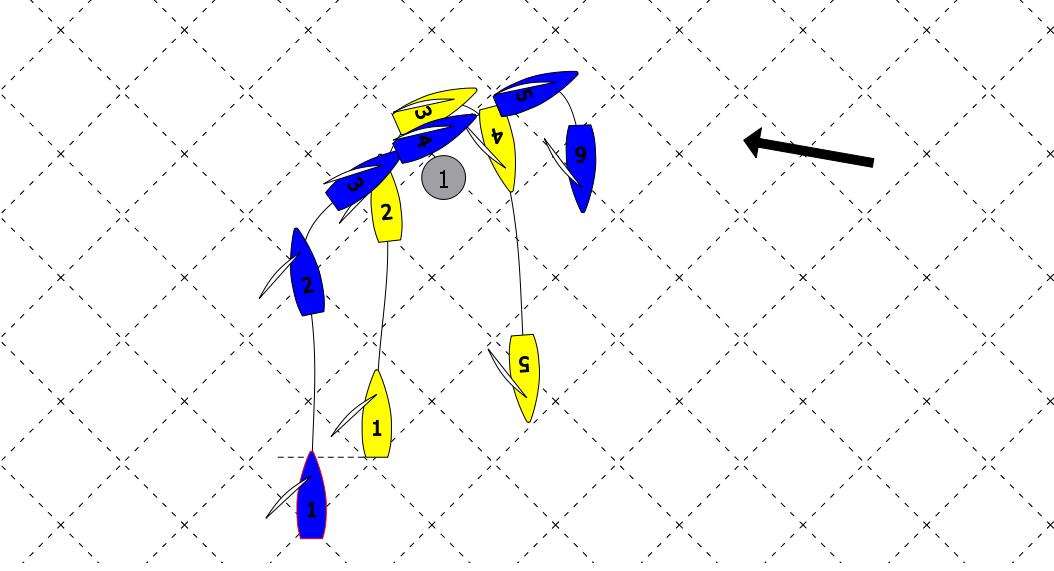

What software is that?
Still at the mark. Ping blue for not giving mark room.

i will try to use the software to show positions but I was 'overlapped to windward and on the indside 'as I approached the mark and the mark would have been alonside my staboard side amidships as I existed the tack on port

Mark-Room Room for a boat to sail to the mark, and then room to sail her proper course while at the mark. However, mark-room does not include room to tack unless the boat is overlapped to windward and on the inside of the boat required to give mark-room. 18.1 When Rule 18 Applies Rule 18 applies between boats when they are required to leave a mark on the same side and at least one of them is in the zone. Best to draw a picture. Boat Scenario is free. http://boats.sourceforge.net/ Fundamentally - where was the mark when contact made?

Hi Rupert, I dont think the tide is relavent as this would apply to any mark where you are reaching in to and away from the mark. The only proper course was to tack round the mark. The Streaker arguement was that once I had tacked the rounding was complete and only port / starboard applied. The question is does it?
Surely there has to be time and opportunity to keep clear following the tack? If the tide is taking you, then opportunity is not there. And if you are still in the process of rounding the mark, then you still have mark room. And, as was said, if a boat deliberately luffs to hit you, they are in the wrong, whatever else happens.
Simon368 ![]() Newbie ![]() Joined: 24 Aug 10 Location: United Kingdom Online Status: Offline Posts: 20 |
case 15 concerns a boat clear astern. A boat clear astern can stop a boat ahead tacking, simple but the Streaker was overlapped on the outside and obliged the give room. Both helms agree with this. Does this still mean the inside boat cannot tack round the mark. If so what was the point of getting the overlap?
Case 25, Luightning to windward and with an overlap was not sailing below proper her course, Case 95 concerns beating, we were on a typical river course. reach down to a mark, tack round it reach back. I think the point in questions is whether the action of tacking from starboard to port whilst rounding the mark is allowed in rule 18 when the outside boat (on starboard) can alter course immediately you have tacked to make contact and call starboard.
