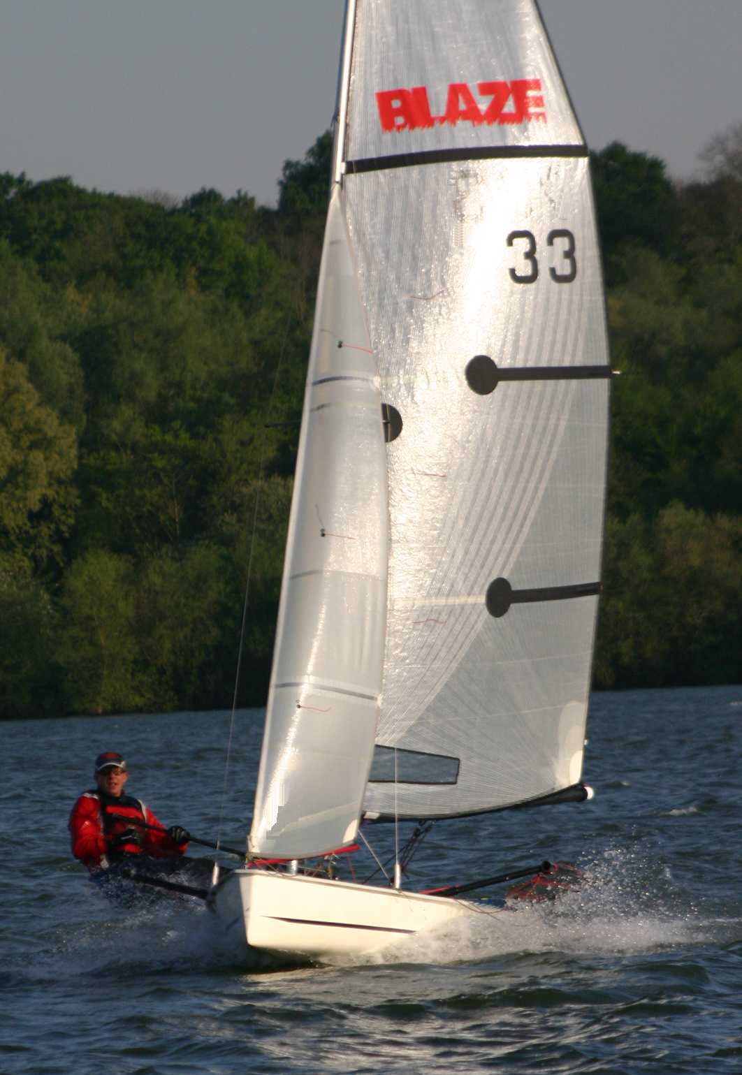

I have to say i agree with all of that. Although i can't profess to know the technicalities of it all in massive detail it sounds right to me. Why didn't they just do that? Sounds like a canoe style rig with a racked hull to me which can't be a bad thing... |

Why is 14 too long? Surely 14ft a better compromise overall? |
RS600 988
Seeing that pic reminds me of just how shocked I am that you gave up that
mainsail for the North sail you now have. |
