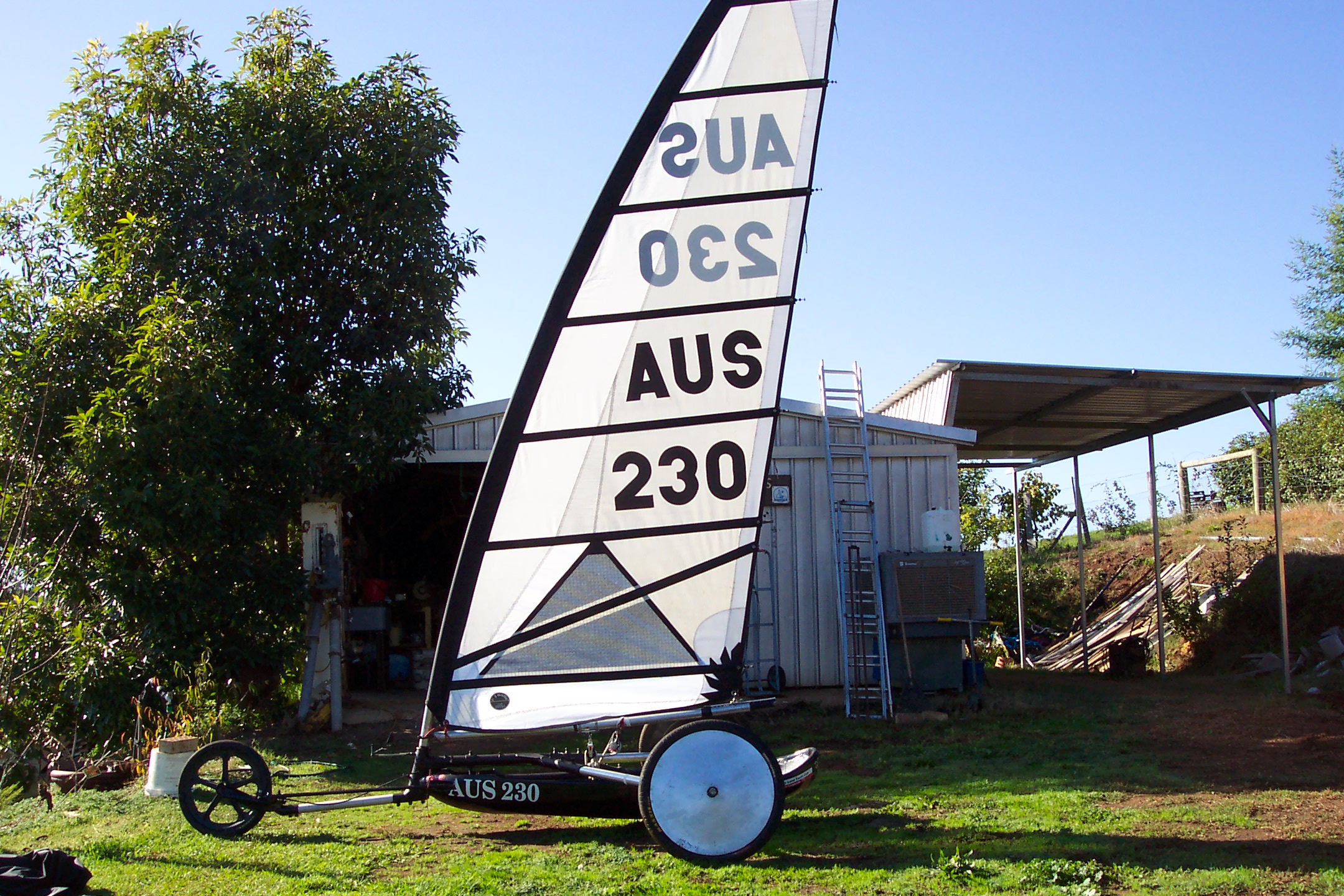

Yes R&J sail. I'm not sure if the sail was designed for the mast. But they are both similar in age! The boom is free floating at the goose neck. I've always been unsure about that. it sounds like its something to try. Because as you relieve the pressure on the sheet the boom does move forward and roll around the mast. Having a rollock would help keep the boom from doing this and help keep the bottom of the soft luff pocket from collapsing forward. Good idea.
There is no downhaul. Only a few yachts seem to run a downhaul system from what I've seen. This is normally part of the sheeting system, so as you sheet in you apply more downhaul. The current battens are fibreglass with a slight taper. They are the white ridged style of batten. In section they look like a cross. |
aus230 ![]() Newbie ![]() Joined: 19 Apr 12 Location: australia Online Status: Offline Posts: 5 |
Gday Jack.
I looks like you use a R@J sail like I use on aus230. I have never had the problem, Is your mast a yorker designed as that is what R@J designed my sail around. We also use a rowlock on the front of the boom maybe that is why mine holds it shape in light winds. Have the battens been tapered? Q: As I have designed and built my own yachts from trial and error. The one thing that I have not been able to get a clear answer on is what distance is the center of the mast post back to the center of the back axles.(Plum for example) Cheers aus230 Edited by aus230 - 20 Apr 12 at 4:06am |

Hi AUS230,
how ya do'in? I think we have chatted on seabreeze before. Good to see you have found this place! Q: I have bad batten poke on my class 5 sail when I'm easing the sheet in the really light stuff. And I find my yacht is very binary when sailing in these conditions. It's either is going fast or isn't going at all. This seems to depend on if I have enough speed to generate enough apparent to sheet in to the point where my battens stop poking out the front. As you ease the sheet you end up with the luff pocket rolling forward and a really nasty 90˚ shape made by the sail / battens. Any advice on this? Much much softer battens? |
