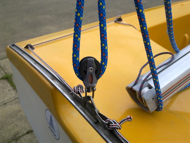

Thanks for that Paul, we have already upgraded the kicker and cunningham to a higher ratio so they shouldn't be a problem, however I'm still tempted to refit the traveller just 'cos it looks a bit odd without it. I was just hoping that somebody might be able to justify its presence, but if it's only going to be of use in strong winds that shouldn't affect us as we probably wouldn't go out if it's blowing hard (boat was purchased to sail with my daughter), Cheers, Nigel
Graduate 2530 'Galaxy' |
Interesting this discussion should happen along just now, I've been going through this exact same thinking with my new boat.
I fancied a bit of a traveller arrangement mounted on a bridge above the tiller so I could do away with all that rope intefering with the wiggle stick as it seems to at only the most inconvenient moments. They're trying to talk me out of it into some other subterranean system I haven't quite worked my head around yet, but if it were me, and it were already there, I'd use it personally, I hate those what do you call them? Horse things?
SoggyBadger ![]() Really should get out more ![]() Joined: 26 Oct 10 Location: The Wild Wood Online Status: Offline Posts: 552 |
Travellers date back to the old days before really efficient kickers when the mainsail leech tension and mast bend was controlled by the mainsheet. The idea was that you could let the traveller run out in higher winds so that you could sheet the main in hard whilst keeping the boom well off the centre line. OK until you get a gust and have to ease the mainsheet when the mast straightens and the sail gets fuller. So it didn't work well in practice. Most owners will have either replaced it or just left the traveller in the centre and upgraded the kicker.
SB |
I would ask this question on the Graduate forum but a) it's a bit quiet on there and b) it's a fairly general question: Our ancient Super Grad came with a stern mounted traveller, however most Graduates seem to use a simple bridle/horse arrangement so I converted mine to that format. Aesthetically the boat looks a bit weird without the traveller because it was obviously designed to have one and I'm tempted to reinstall it. What are the advantages of using the traveller ? and how would we use it ? (the previous owner had locked the traveller at the centre and left it there. As I'm new to sailing 'double-handers' I don't want to find myself with too many controls, especially if they don't offer any advantages. Just in case it's relevant we use off the boom sheeting with a 40mm Harken ratchet mounted on the boom, Many thanks in advance, Nigel ![]() ![]() |
