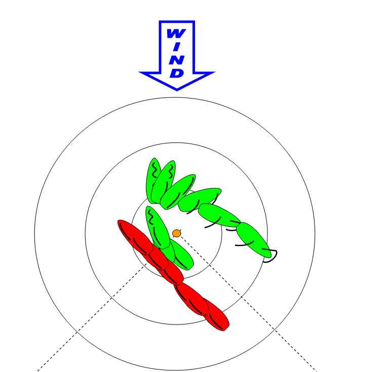

Here is how you deal with the problem
replaced image bu oploading to another part of the Y+Y forum and then loading picture here!!
Green arries first and SLOWLY heads up (assuming nothing above) and at some point they should scoot enough to windward to make them "safe" and then tack.
Diagram is not 100% accurate as if red followed green you would not see the start if the green "track".
Edited by Scooby_simon
