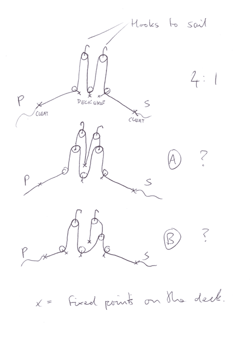

Have a look at the below picture; The top system is the standard 4:1 purchase on the Musto Skiff, the blocks hook into two loops one each side of the sail (same as a 29er & 49er). What is the purchase ratil of system A & B? In in the case of B is the purchase ratio the same on starboard and port? There must be some mechanics graducates out there ... regards,
