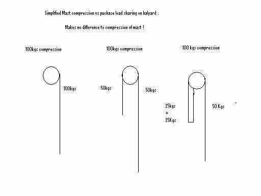

Post Options Post Options   Quote farc anal Quote  Post ReplyReply Direct Link To This Post Posted: 17 Mar 09 at 10:32am
Very simplified.

Nice drawings, farc anal, but wrong figures.
With a simple 1:1, if the sail takes 100kg to hold up, there will be a further 100kg compression loading from the halyard running back down the mast unless you use a halyard lock (with all it's amusing whims).
With 2:1, you halve the load in the halyard, so that there's only an addtitional 50kg going back down the mast instead of 100kg.
So compression's 200kg for 1:1, 150kg for 2:1, or 100kg (and good luck reqd) for a halyard lock.

Post Options Post Options   Quote farc anal Quote  Post ReplyReply Direct Link To This Post Posted: 17 Mar 09 at 12:59pm
perhaps you are miss- interperating my simplified crappy sketch above .
put more less   simply , compression is product of down force generated on the mast tip , through combination of downhaul/cunningham tension , halyard tension , kicker,mainsheet , rigging , gravity ,  all acting together . to create a compression force .
once rig is set up doesn't matter how many purchase you use - you are only trying to create the SAME compression on the mast for set conditions , the loading on each individual purchase is less as you add purchase , but together add up to the same sought after compression .
off course you can increase compression by adding more purchase , but as  above you are only looking for a specific amount of compression at any time, as you say yourself adding 2:1 halves the load on halyard - actually most halyards are two to one think you mean three to one if you want to nit pick .
The max compression is when tack /cunnigham is pulled down as far as it will go with head as high as it can be .
Mast locks work not because they reduce compression- they don't  , but because they eliminate halyard stretch , no less load on mast at all . they can be a pain to use at times , but they  work ,thats why they are used in top competion where possible/allowed  , VOR , Americas cup , Finns , Etchells , humble cats ,Ok's etc etc
PS My Bad , figures are wrong above , the example of the 3:1 halyard on right should show 33.33333333333 kg pull on each leg giving the SAME 100 kgs Compression , in all cases compression generated by factors expressed above
Edited by farc anal

Farc Anal, has just provided my explanation that I couldnt think of last night, and I couldnt agree more with it.
Therefore 2:1 only benefit is the ease of pulling the main up. Once up there is no benefit although I find it can lead to loss of tension as the head moves along the line slightly. And when lowering it you end up in a tangle.
