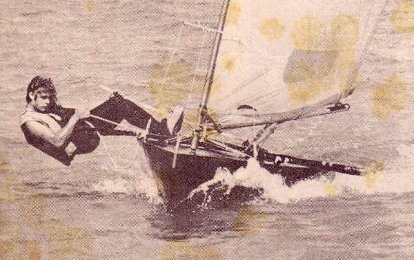

But of course like nearly every other 'new' development this was first used in victorian times, or more recently in the Int Moth class !
see pic of a Moth from 1974 with a kicker strut ( gnav is such an ugly word ) ![]() Edited by I luv Wight |
The advantages of the strut: ( in development classes )
Lower boom and therefore longer mainsail luff. More room for the crew in light wind to dodge from side to side without getting stuck on the kicker tackle. Less all up weight if a mast frame /stump is used. The weight of the stump / frame and gooseneck is included in the hull weight, so there is less weight in the unweighed shorter mast and no gooseneck. The forward/side pressure of the strut is best taken by lowers to the attachment point of the strut on the mast, but could be a compromise to have the lowers halfway between the top of the strut and the spreaders - so stiffening the whole lower mast section. ( like on the yummy new the xenon !) or in 29ers by having a thick mast. |
Well, I'll be ......somethinged. Where'd the pic come from? Do you know who it is? Damn they were good times in the Moths, those days. |
Ray Hutchings ( now a keen surfer ) in an AUS origin moth ( built before 1974 ) from a short-lived mag called Yachting & Boating Weekly (!) and also of interest - the slow handicap result ![]() |
Ahh, that young Pattison chap must have just fluked that result, he will never amount to anyfink.
I don't recognise the boat 'tho I'm no expert. Unusual to have an Aussie skiff in '74. Just possibly an old Daring Moth; probably not a Brown "Good Grief" because he says his had scow-type sterns and this one seems to be very flared at the back. Plus I thought he created it in '74 or later. I can't see any hint of a chine, though. The boat may be Aussie but I never heard of GNAVs out here in those days. Innnteresting, very interesting. Do you have any info re Victorian era inverted vangs? I've seen nothing. BTW, I must modify my earlier claim; if it wasn't in Canoes, Rs or Moths, it wasn't invented. OK, maybe add N12s (U shaped hulls). Oh, and 18s (modern Assys) as well. Yeah, well maybe Firefly (first SMOD?) too. Of course, most of the Moth ideas were in Canoes first...... ![]() Edited by Chris 249 |
