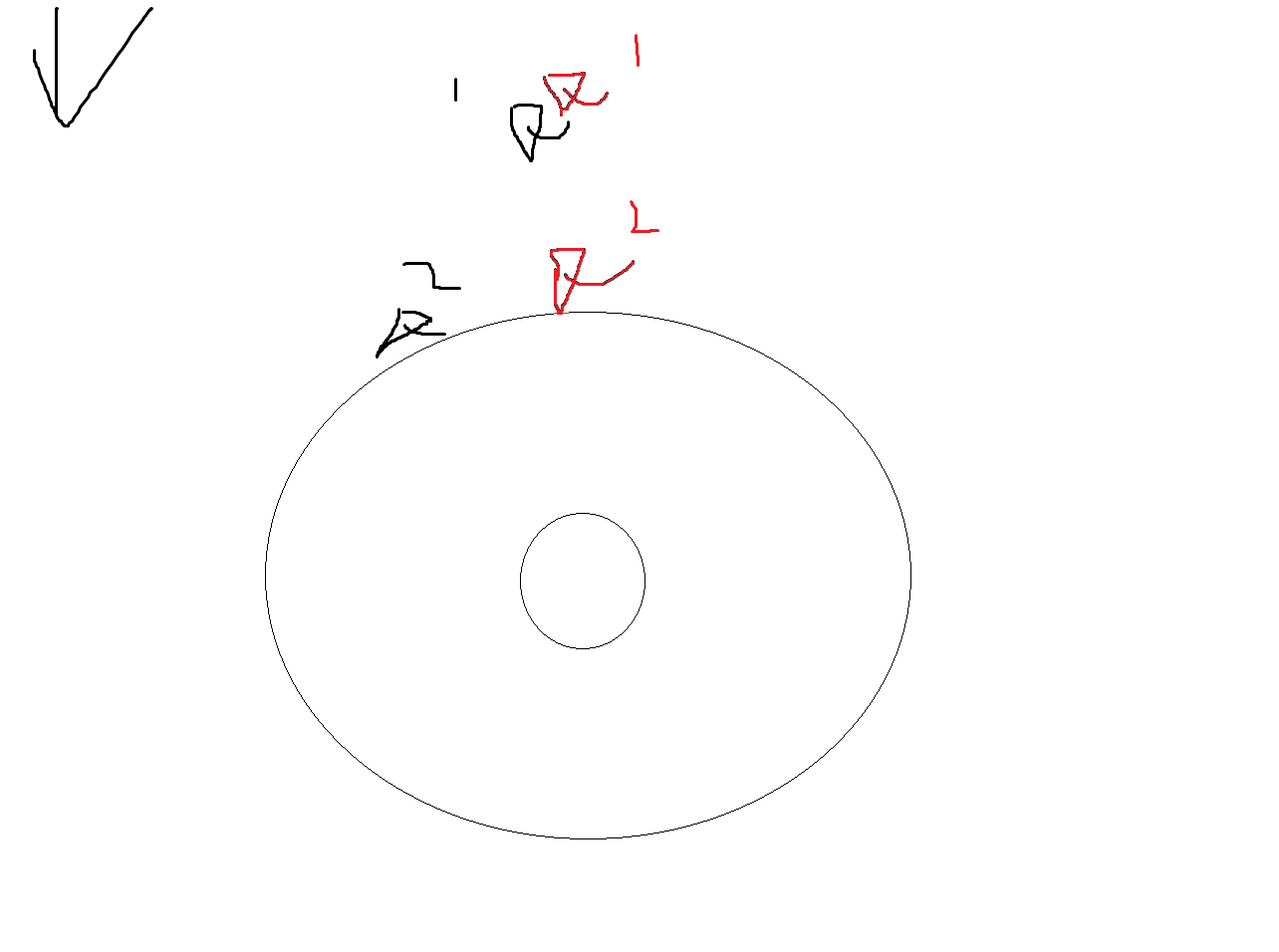

Interesting that I've never considered the outside boat to get mark room while being the outside boat purely by being clear ahead.
Tactically if you were overlapped outside approaching the zone you could head up massively to ensure you're clear ahead, all be it not heading anywhere near the mark.
Here boat 1 would get mark room from 2?

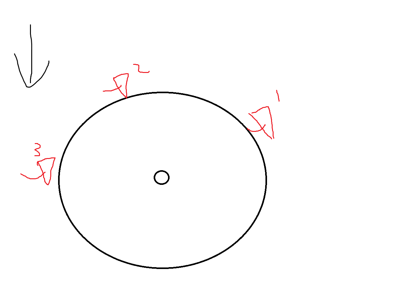

It mostly looks very promising to me. There does seem to be a potential game change I don't like - If I understand the material correctly, in the event that a boat clear behind reaches the circle before a boat clear ahead then the boat clear behind gets mark room..
I presume on the current rule it doesn't specify that its only when the first boat reaches the zone. Only when overlapped, which they clearly aren't? After reading all of this I couldn't tell you why I thought with the current rules 1 would be entitled to mark room from 2 but 3 wouldn't be entitled. I've just always thought they were
Other than that I thought it was definitely easier to apply the rules on the test compared to the old one.
Another way to consider that is that *by definition* you cannot be (clear) behind if you reach the zone first.
Post Options Post Options   Quote JimC Quote  Post ReplyReply Direct Link To This Post Posted: 26 May 22 at 9:31pm
Trouble is I think you can. If you consider the boat clear behind entering the zone directly on the rhumb line, and the boat ahead entering the zone at about 10 o'clock
Post Options Post Options   Quote Guests Quote  Post ReplyReply Direct Link To This Post Posted: 26 May 22 at 10:11pm
Hmmm, I see what you mean but if you consider the race to be a race to a series of waypoints rather than the one furthest downwind, then the first boat to enter the zone is the one nearest the waypoint and therefore ahead.
Post Options Post Options   Quote JimC Quote  Post ReplyReply Direct Link To This Post Posted: 26 May 22 at 10:21pm
Definitions.
Clear Astern and Clear Ahead; Overlap
One boat is clear astern of another when her hull and equipment in normal position are behind a line abeam from the aftermost point of the other boat’s hull and equipment in normal position. The other boat is clear ahead. They overlap when neither is clear astern. However, they also overlap when a boat between them overlaps both. These terms always apply to boats on the same tack. They apply to boats on opposite tacks only when rule 18 applies between them or when both boats are sailing more than ninety degrees from the true wind.
So ahead and astern is only related to the position of the boats, not to the position relative to the course.
Post Options Post Options   Quote Guests Quote  Post ReplyReply Direct Link To This Post Posted: 26 May 22 at 10:34pm
Change the definition of that then, whilst reworking rule 18.  Might cause confusion in a match race situation where boats are sailing away from the mark though!
