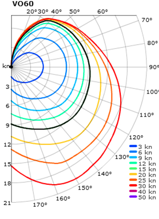

Downwind always known to be slower than a broad reach. If you can do 4kts dead run, you can probably do 5 on broad reach.
If you had a 1nm leg, doing 4kts you will complete in 15 minutes.
Let's say you go 30degrees off the wind angle at 5kts would be less than 14mins if my maths is right

Your maths is correct but there isn't much in it. By sailing 30 deg off DDW you will sail 115% of the distance. If your boat will sail at 120% of its DDW speed then, yes, it is faster to head up. But will it? I guess if it were cut and dried we wouldn't be having this conversation. Nick Craig says 'soak if you can but during your practice sessions experiment with other angles' if I remember correctly
Pretty sure this is the art of racing. Knowing do you go 5, 10, 15, 29, 30 degrees for the conditions. Plus Reading the shifts and the conditions.
You only need to get a boat length ahead for things to matter.
My example was picked for simplicity of maths.
Polar plot from a Volvo Ocean 60
Not the perecntage difference changes by wind speed.
Not sure what matters?
Get three identical boats to round a windward mark in quick succession. Boat 1 - dead down wind. Boat 2 - 10degree, Boat 3 - 30 degree...
Who hits the downwind mark first...?
This is why good racers practice. They are testing different approaches
