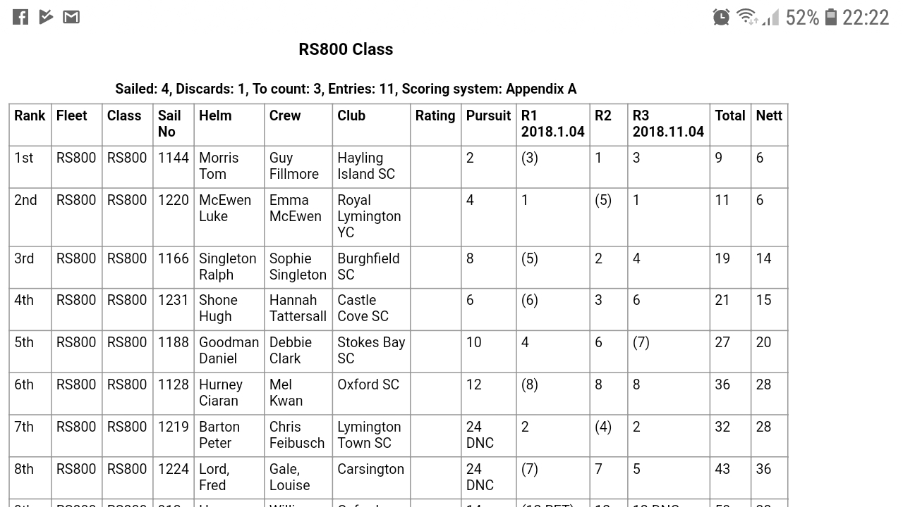

Post Options Post Options   Quote JimC Quote  Post ReplyReply Direct Link To This Post Posted: 05 Nov 18 at 6:28pm
It does seem a little bit ambiguous.
The way I read it the race scores in the pursuit race are 1,2,3,4, like all the other races. The pursuit scores are then doubled when the series total is calculated.
So that makes me think that
1144 scores 1,1,3,(3)
1220 scores 1,1,2,(5)
Which means that 1220 gets the series under 8.1 on the 3rd result.
The pursuit doesn't have any special weighting in the tie break.
I'm not sure if I could get Sailwave to calculate that though!
If on the other hand the pursuit score was doubled for the discards then
1144 scores 1,2,3,(3)
1220 scores 1,1,4,(5)
and 1220 still wins, but on the second score.
Doing it like this has the surprising effect that the pursuit is down weighted. This would be much easier to set up in Sailwave.
I think if the organisers wanted the pursuit to have extra weight in the tie break they'd need to set up up like a medal race, where the result in the pursuit is the first tie break. It would get awfully complicated though.
Edited by JimC - 05 Nov 18 at 6:34pm

I haven't see all the SIs, or the results, so its hard to give an opinion. But its beginning to sound as if the SIs were written so that in tie break terms all the races were equal, and the doubling of points only applied when totalling the points. If so it must have been fun to set up in the scoring system!
To be frank, I don't feel like we deserved to win. We lost because we let a lead in the last race slip away to a third. But just throwing this out for discussion, because Appendix A works for results where all races are treated equally. Changing the scoring so one race is given an elevated status is unusual and it must have caused some problems otherwise the result would have been consistent (results below are wrong, we actually came second, but were the result from the 200s).
The overall format of the event was super and great for a cold end of season event to bring all the classes together. Plus we had some of the tightest races of all season in the 800 on Sunday.

Post Options Post Options   Quote JimC Quote  Post ReplyReply Direct Link To This Post Posted: 05 Nov 18 at 4:59pm

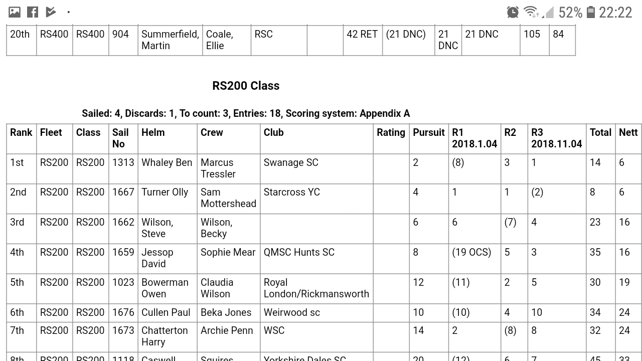

Post Options Post Options   Quote sargesail Quote  Post ReplyReply Direct Link To This Post Posted: 05 Nov 18 at 2:16pm
Mozzy,
The 200s were in error, which is being corrected. The results aren’t up yet because they are being reworked in a publishable format.
If you have another look at the SIs you’ll see that at 17.2.1 the score from the pursuit race will correspond to the position within that class only.
So as you say your score was 1. Which takes you to an equal number of firsts and thus to the next tie break which is dealt with in the normal way.
17.2.3 which you quote emphasises this: the pursuit race SCORE is doubled to create the total points score
Personally I think it’s great that in the 9 classes racing was so tight that there were ties for first in 3 and also for third and fourth in one.
Of course for you in the 800s it makes no difference to the order: without scoring your pursuit race first as a 1 for tie break purposes then you would be second by virtue of having less firsts. Same in the 200s for 1&2 and 3&4.
