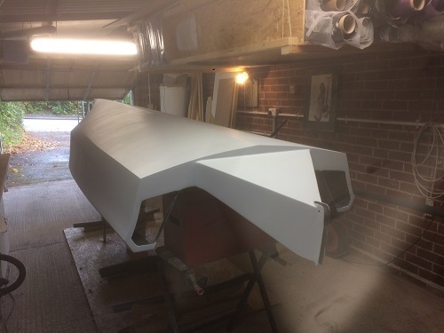

The gantry is not allowed to behave like it extends the hull skin, similar wording to most box rules inc moth - which even has to be removeable.

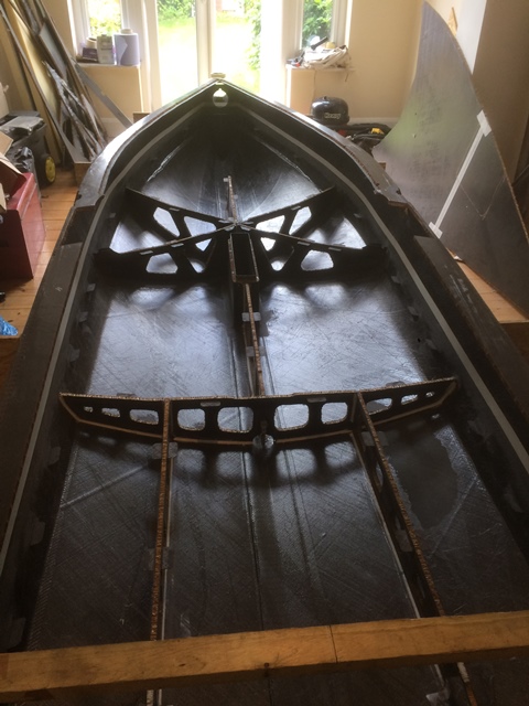

Mine is pretty normal in most respects although there are a number of other ways to do it. Mine is moulded into hull so easy to build, and is bouyant. It is immersed at rest but as soon as under way the transom runs clean and it doesn't contribute bouyancy, even when trans at CL is > 200mm below waterline at speed with aft trim. The gantry is cranked upwards such that the bottom of the stock is ~ 120mm above a line projected off centreline of hull. I wouldn't want it to be any less, otherwise the stock is getting wet and dragging. The gantry is quite close to transom edge at its sides as I only have ~ 100mm of cantilever section depth and this sees big loads from foil when sailing, but even bigger ones if grounding. This number is small as I went for a low dancefloor - one of many compromises. There are long bhds extending fwd from the intersection of gantry and transom to resolve these.

Gosh, that's very Veed. Almost looks like a Jennifer Julian Cherub, and I bet you've never seen one of those.
