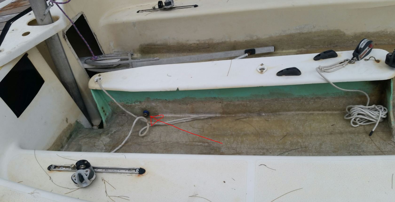

A question for anybody who has a moment. She takes in a little water via the area of the bolt that hols the retractable centerboard. I am thinking that the bolt just needs tightening and maybe a new makeshift 'washer' , the current blue one on there just looks like it was a DIY job with someone using a piece of closed cell EVA. Any suggestions on the best way to seal this up?
In the picture attached i have shown the bolt that i am referring to with the red arrow.
Thanks again to all . Warm regards..... |
Some will always leak, depends how much water is coming in, if it's only when you are moving check slot gasket on hull, this is two parts, centre board is gripped by these, stops water being driven up into case.
You can also coat bolt in grease and fill hole with some sort of sealer, this will stick to case, but not to bolt. |
Bath sealant will usually stop the leaks. Just loosen off the nut, put a ring of sealant round each side, gently tighten and leave to cure. Then finish tightening, but don't over do it.
