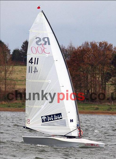

With he 300, when you think you have loads of kicker on you are usually half way there!  In bug stuff, it would scare you 100 boys the amount we crank on, but it really transforms the boat.  I tend not to use the out-haul as an aid to de-power the boat, i use kicker and sheet control as well as pulling the board up a fair old chunk (say 30cm)  When i have run out of kicker, i pull on the cunningham, when i run out of Cunningham its basically so windy the world is probably going to end and the Phantom boys would only manage two out of the three races!
Second that. On the 300 we set up the gnav so that there is a bit of prebend in the mast when the kicker is fully off (blocks beginning to pull over the rollers). If you don't thave any prebend you will not be able to get sufficient kicker on upwind in a blow.
When Russ says use lots of kicker he means use LOTS of kicker. It's all about power management. If you're overpowered upwind pull on more kicker, if you feel underpowered let a bit off. In an unstayed rig leech tension, mast bend and therefore sail fullness are all interlinked so kicker is the primary control. From top end of force 3 upwards be prepared to pull the kicker on block to block. In a 300 this means that the top of the mast is behind your sitting out position (i.e. loads of mastbend).
The mastbend means that the top half of the sail is board flat (good) with power generated by the lower half. For this reason don't pull on much outhaul until it gets seriously windy as you'll need some grunt low down.
As an indication my avatar is in a force 2. This is the mastbend in a force 5. Note the angle of the kicker bars to the boom.
Steve B
RS300 411
RS300 page
Steve411 View Drop Down
Joined: 09 Sep 08
Posts: 705
Post Options Post Options   Quote Steve411 Quote  Post ReplyReply Direct Link To This Post Posted: 30 Mar 10 at 9:59am
Originally posted by ChrisC
Rob,
Thanks for your update.
I am pretty keen (very keen actually !) to find how best to depower the
10.2 for upwind in a bit of breeze - I was actually pretty overpowered in
not a lot of breeze !
Having not sailed a 300 I am not sure just how much kicker can be
applied - anyone got any advice on this ? I understand the principle that
initially kicker is generating power and that it then progressively reduces
power by flattening the sail and lowering the COE. Just not how much we
are talking here (dont want to break it !!).
Also I did find pulling on the outhaul helped. Initially the boom strap was
resting against the mainsheet tie-off point (i.e maximum eased) and I
was
getting hammered ! Found life easier later when I pulled it on some.
However, I note from the 300 tuning guides they dont really stress
outhaul as a depowering device.
I am looking for advice here as I have no experience at all in boats where
on the water tuning is critical. Most of my experience is in set-it-and-go
type boats.
Second that. On the 300 we set up the gnav so that there is a bit of prebend in the mast when the kicker is fully off (blocks beginning to pull over the rollers). If you don't thave any preben you will not be able to get sufficient kicker on upwind in a blow.
When Russ says use lots of kicker he means use LOTS of kicker. It's all about power management. If you're overpowered upwind pull on more kicker, if you feel underpowered let a bit off. In an unstayed rig leech tension, mast bend and therefore sail fullness are all interlinked so kicker is the primary control. From top end of force 3 upwards be prepared to pull the kicker on block to block. In a 300 this means that the top of the mast is benind your sitting out position (i.e. loads of mastbend).
The mastbend means that the top half of the sail is board flat (Good) with power generated by the lower half. For this reason don't pull on much outhaul until it gets seriously windy as you'll need some grunt low down.
Steve B
RS300 411
RS300 page
