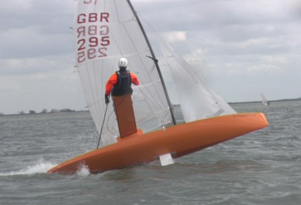

must be difficult hanging on at that speed |
big man ![]() Posting king ![]() ![]() Joined: 04 Feb 05 Location: United Kingdom Online Status: Offline Posts: 161 |
accelerated a little too fast maybe
keep it flat you t***
bigwavedave ![]() Really should get out more ![]() ![]() Joined: 04 Jun 04 Location: United Kingdom Online Status: Offline Posts: 944 |
Or stopped a bit too quick
I think they've just sailed up and over the top of a wave. I know that weightless feeling, I used to crew for a guy in the early days of the RS800. He used to sail a Contender and hadn't got used to the extra speed of the 800. In a breeze, at the windward mark he used to bear away so fast that my feet left the rack. The solution was to kick him on the shoulder which gave me enough momentum in the right direction that there was a chance I'd come back to the rack in roughly the right place, rather than behind the boat, or infront of the jib!
