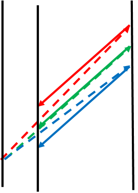

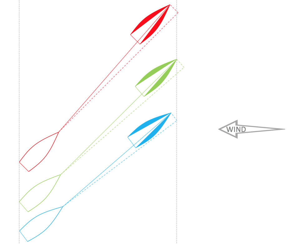

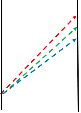

First diagram, three boats sailing in the absence of any tide with 4 degrees leeway. The green boat makes best VMG. Red and blue are footing and pinching respectively, and VMG is slightly down.
What number have you used for the drop in VMG? Looks like you've made up that number, which by eye doesn't look to far off. But really you'd want a speed polar if you were to be making this point on any scientific level.
I did make these numbers up, but they are vaguely realistic and based loosely upon a VPP I run occasionally. And no, I'm not sharing the VPP. In any case, to make a general point it is not necessary to have actual data – all that would happen then is that I would be accused of demonstrating the case for the Laser (say) but not showing the case for all other boats. Far better to use generic, vaguely realistic, values to demonstrate the general case.
Generally yes, but in this case VMG, or speed for a given heading relative to wind is the crux of the discussion. So I don't think it can be ignored or generalised.
Originally posted by Peaky
I don't follow – the blue boat is pinching not footing; the red boat is footing not pinching. At any rate, as explained above, I have assumed a constant leeway angle of 4 degrees. This assumption does not materially affect the conclusion.
Okay, yes, if you assume the boat lifts it's board to keep leeway (AoA) the same. But again not stated and often not what happens in practice.
So let me say first off I didn't want to get into detail on the math's, the numbers and the second order effects. I know that opens it to scrutiny but a. I'm lazy, b. I'm busy c. Most people prefer pictures to numbers d. It is unnecessary distraction. And this is the Y&Y forum, not Chesapeake Yacht Symposium or RINA Transactions. That said, I do feel the tone of your post was a little unnecessary, but maybe I’m a snowflake.
Hitcher had the excellent idea of assuming a wide groove with the boats all having equal VMG in no tide. Unfortunately, Mozzy’s diagram is misleading because it does not account for the large change in heading relative to the true wind that can be achieved. The diagram should look like this, which reinforces the point that footing, not pinching, is the way to go. All references to leeway removed to make it clearer.
Okay, this I still don't get, so possibly it's my turn look stupid, and i'd like to learn. But, if their VMG is the same in no tide, if that is the premise, then how come their VMG is different before you added the tidal vector  in the second diagram? Clearly the red boat has got ahead before you apply the tide. You say this is because of the wind shift, how so?
Is the wind your showing is true wind (on water) or true wind over ground? The current changes the true wind (over water) just the same for all of them. So what factor are you applying? There's obviously some additional calculation or adjustment you are making here. Can you tell me what that is?

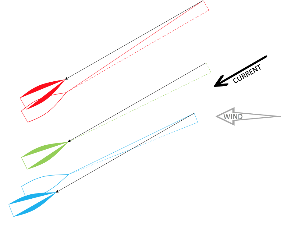

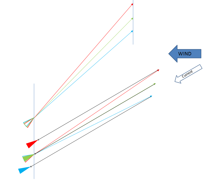

Second diagram, the three boats are sailing in tide at the same angle to the apparent wind (but much closer to the true wind). The red boat is pointing straight into the current but due to leeway has the current on the windward bow, the green boat is leebowing (but it’s path is straight into the tide) and the blue pincher is leebowing even allowing for leeway.
Speed through the water for the three boats is exactly the same as the first diagram without tide (as the apparent wind is the same) but speed over the ground obviously isn’t. The green boat goes literally no where to an inertial frame (land based) observer. The red footing boat slips to leeward, but VMG now matches the green boat. The blue pinching leebower slips back faster than when there was no tide!
Blue and Red's VMG shouldn't be any different relative to the other boats in the tide than on the lake. Which tell me something has gone wrong, but with out you stating your assumption it's hard to work out what.
Have you measured the vectors or is all drawn by eye? Looking at the lengths of the vectors for speed though water (without leeway) they seem different in tide versus no tide.
Also, in the first diagram you compare where the aft leeward quarter is, versus bows at the end, in the second you just have a line through the starting transoms (and the gain line out right is redudant??). This artificially makes the blue pinching boat look better in the first diagram than the second, just because of how their heading orientates the boat against the VMG gain line.
Again, I'm not sure just assuming a non-specified VMG difference for footing and pinching is adequate, when essentially your whole argument is about the effect that footing and inching has on your VMG (with and without tide.
Moral of the story. The green boat sails best on a lake and best on the sea. It should not be tempted to pinch to leebow, but can foot off with no loss of speed.
The moral of this story is to include more information about the key assumptions you are making. GRFs whole premises is that when he pinches above the tide his VMG doesn't drop, because of getting 'flow' pushing the foils, or some rubbish.
I think if the math had been done correctly, then the relative VMG differential between footing, pinching or the best VMG mode would be the same on a lake as it is on the sea. So, unfortunately your story is incorrect and unfortunately another good example of how with good intentions it's easy to spread bad advice.
In fact, the vector lines may be correct, and it's just how you've compared bows against leeward aft quarter that is making the pincher look worse in tide versus no tide. Or some combination of the both.
If you repeated this exercise but with a consistent comparison of relative positions (central axis point of the boats) and use some real life polars for angle and speed which already accounts leeway then I think you'd have something informative and useful.
