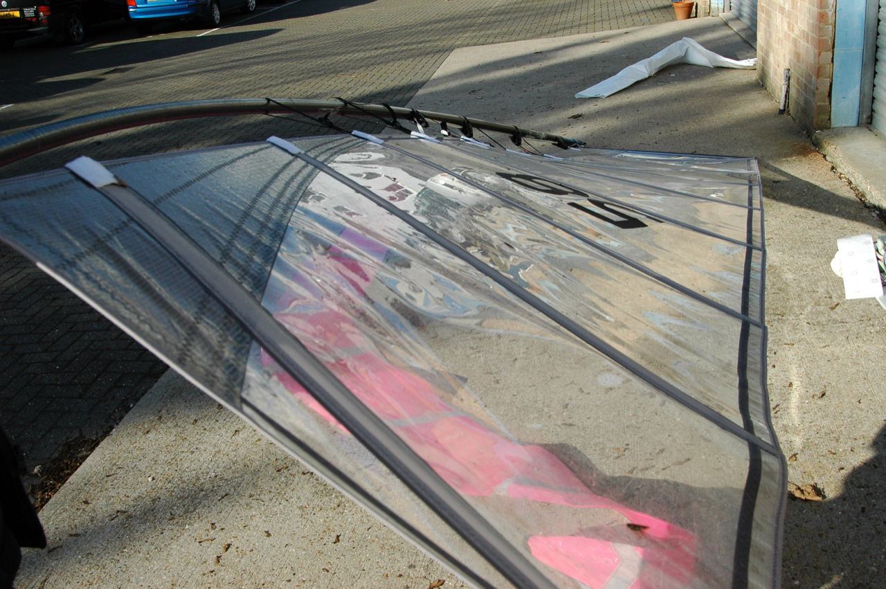

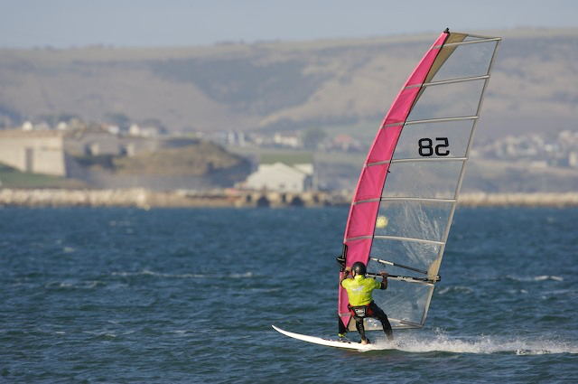

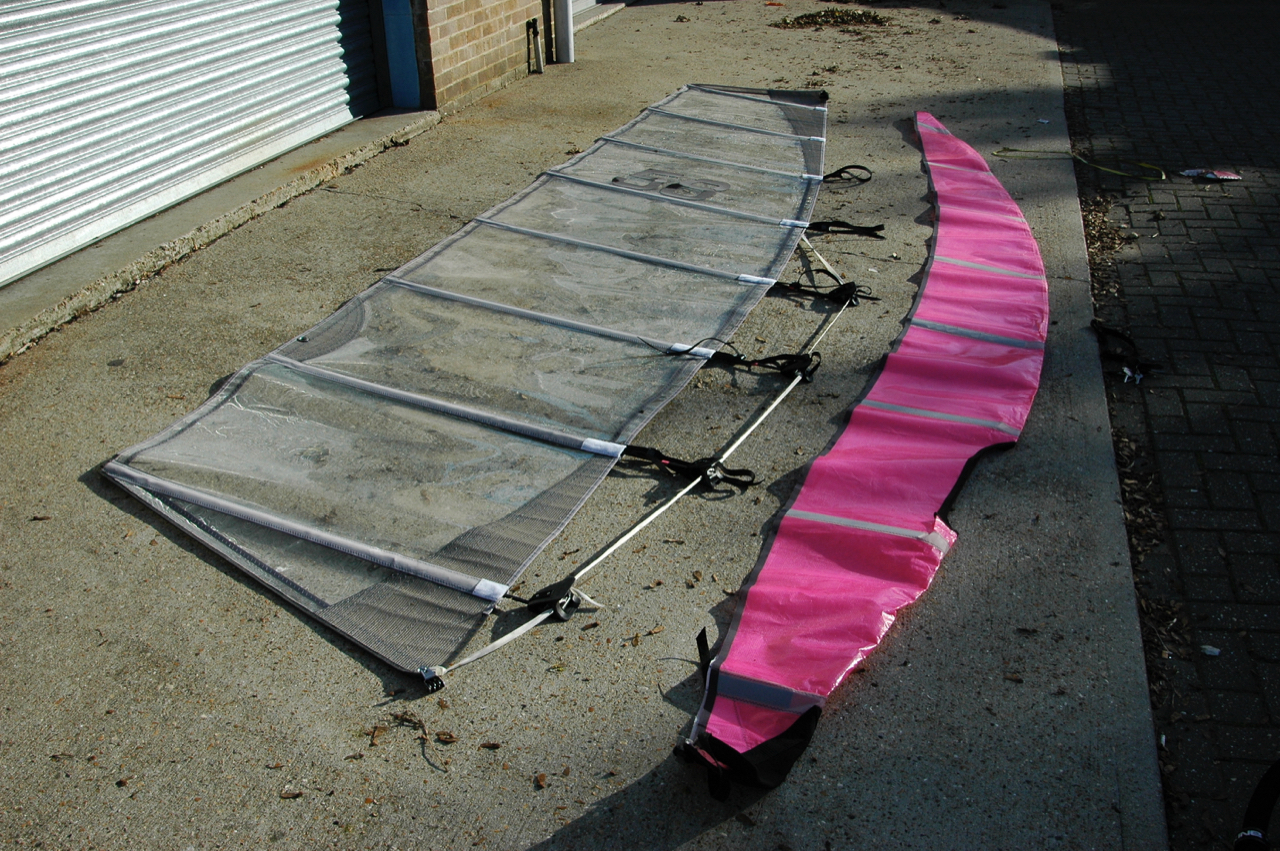

Here's my radical sail development which allowed the luff curve to be radically altered to vary the twist which actually worked, but the craft I tried to use it on which became knicknamed the Water Pusher, by my nephew who was an Olympic hope(less) at the time and ended up with me clinging to a buoy waiting to be rescued The sail had constantly variable luff curve which enable me to go quite fast, it also allowed me to survive a 48 knots of wind run alongside Those big kids Dunkerbeck and Dave White, unfortunateely the 48 knot squall was a header so none of us went particularly fast, but the fact I got through carrying 2 sq mtr more sail than them proved my concept. (It was 7 sqmtr). To adjust it you use the straps to induce more negative curve at the head and more more positive in the mid section with the mast already pre bent and a sleeve to covere the innards. ![]() ![]() ![]() ![]() And here's the fateful water pusher that failed. ![]() ![]() |
Very cleaver and professional, sounds like it had a lot of potential, what you were trying to do with the board makes sense. Maybe too much of a quantum leap in one package.
