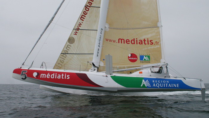

My word, that's it!
Bootiful was a planing cat, as is this:

I ran some numbers on a planing cat while i was at uni (I liked the idea on paper, If i find the files i'll send them), I even did an iteration where it should plane while flying a hull (asymetric hulls), the net result was that you ended up either going back to something more like modern a-class or F18s or you go back to a mono that looks like Vlad Murnikov's SpeedDream. It was interesting chattting to the C-Class guys at the boat show this year, their current hulls were designed to plane, but they have found it doesn't work and the next ones will aim to minimise wetted surface area instead.

Planing cats can work... Set some records if I remember rightly. |
