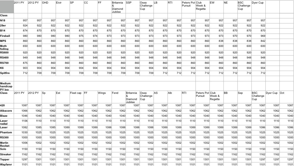

as promised a couple of pages back, list of changes for classes throughout the season. ![]() |

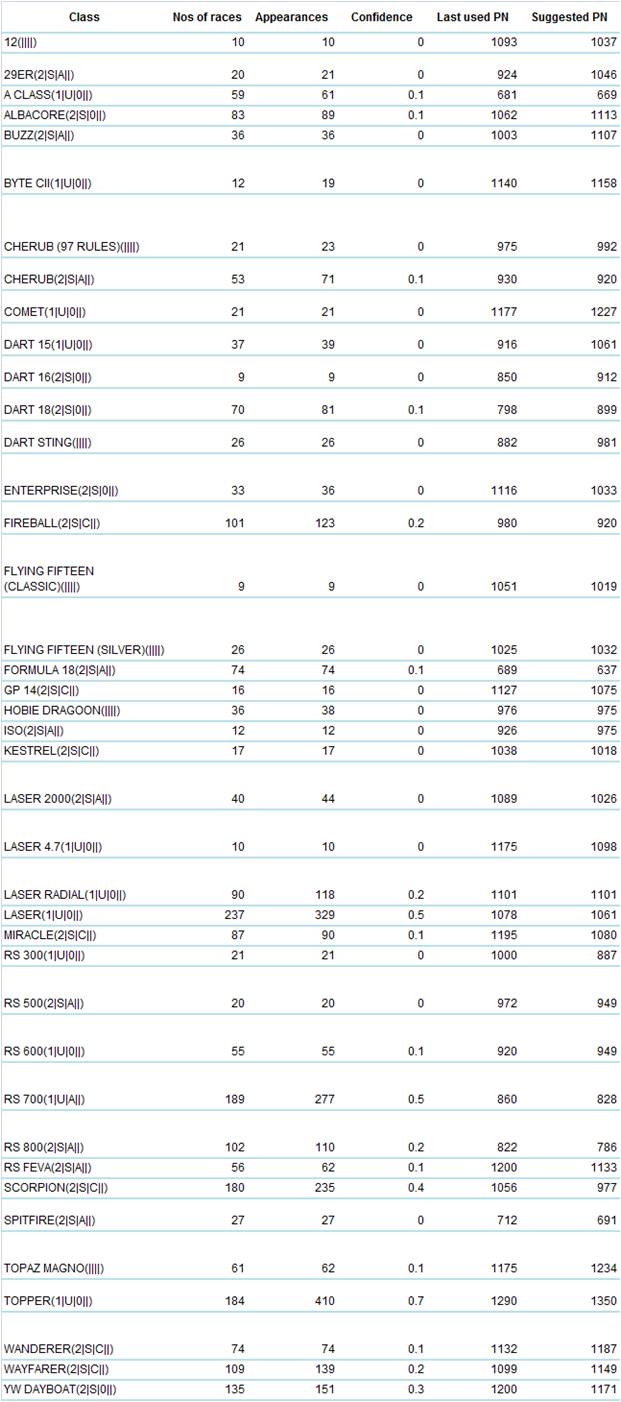

So for those interested in the suggested changes for a tidal estuary, here are my clubs latest figures from PYS.
You have significant data, yet you are suggesting a PY 8% different from what you are using? That is an immense difference, how do expect people to take your racing seriously if you spread the word that the py's are that badly wrong? I suspect you have some good sailors sailing Scorpions? |
looking at the numbers id say that either the river/courses are very biased towards symmetric classes, and/or that the better sailors are in the symmetric classes.
Looks like the RS700 figures would challenge one of those possibilities? It seems to me the current adjustment scheme really does not work in the real world where ability varies from class to class. |
