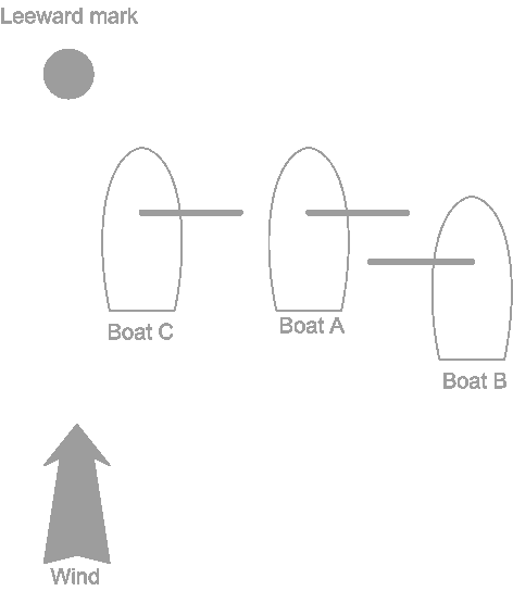

Situation: Two Beetlecats approaching the leeward mark, both running by the lee. The mark will be taken to port. Inside the zone, boat A is on port tack and is the inside boat with an overlap on boat B. Boat B is on starboard tack. Boat B (outside boat) calls "Starboard!" and bumps into boat A; B's port rail hits A's starboard rail, a light tap/rub, no damage, no change of course by either boat.
Question: Which rule 'trumps'? Rule 10 says boat B (outside boat) has rights because B is on starboard. Rule 18 says boat A (inside boat) must be given mark room. Possible extenuating circumstances (I don't know if these are germane to the question): 1. Rounding the mark, boat A (inside) will merely harden up while boat B (outside) will gybe. Rule 18.1.b states rule 18 does not apply at all (quoting the rule here): "...when the proper course at the mark for one but not both of them is to tack." In this case, neither boat tacked: one gybed, one just hauled in. So IMHO rule 18 applies...agree or disagree? 2. Actually there were three Beetles. On boat A's port side was another boat C, also on port tack with an overlap on A and B. Boat A was giving C room at the mark. Does C constitute an obstruction for A? If so, doesn't that mean B has to give A room? My weak attempt at a diagram below. Posted by a newbie, please advise if I can supply more information. Thanks very much for your time and comments. ![]() |
--JJ
So rule 10 is valid, but is restricted by rule 18. By your description the outside boat didn't give required room and should take a penalty. |
No rule trumps. Different rules place different requirements on each boat.
C is windward of A. C must keep clear of A as a windward boat (11). C also, as an inside overlapped boat, has right to mark room from A. A is leeward of C. As RoW boat wrt C, A must alter course in such a way as to give C room to keep clear (16.1). C must give A mark room. A is on port, and B is on starboard. A must keep clear of B (10). As inside overlapped (by definition) boat, B has to give A mark room. When B alters course, she must give A room to keep clear (16.1). |

Hey JimC and Presuming Ed, thanks very much for your explanations. They make things clearer. Presuming Ed, one follow up: In line 2 of your reply, you say, "C also, as an inside overlapped boat, has right to mark room from A." But in the line just below that, you say, "C must give A mark room." Was that what you meant to say? Don't those two statements conflict? Just tryin' to get this stuff figured out... Edited by JohnnyJupiter - 21 Aug 12 at 9:37pm |
--JJ
Twas a typo. Should read "A must give C mark room".

Definitely agree with the above, his actions are limited once you are in the zone. He MUST give mark room for both A and C which is 'room to sail to then proper course at'.
In reality what he should have done is squeeze you both up a little then slow down and try to nip through the inside gap that would have been created. If his rules knowledge stops at port/starboard then he needs to get educated IMO.

So now I'm struggling with an apparent contradiction in my mind, having to do with 'keep clear'.
In the situation I've described above, I think boat A is required to keep clear of boat B, while at the same time boat B is required to give me mark room. Two questions: 1. Am I (boat A) required to keep clear in this situation? Why or why not? 2. If I am required to keep clear, doesn't that mean I have to sail a course that allows boat B to sail her proper course to the mark? It seems to me that 'keep clear' and 'mark room' oppose each other in this case. Sorry to flog this horse, but as I learn the nuances new questions keep popping up. Thanks for your indulgence. |

In your original post you asked whether rule 18 'trumps' rule 10.
I have to disagree with PEd: I think that to say rule 18 trumps rule 10 is quite a good way to put it. At the expense of reciting the analysis PEd had already given, here's how. C (to windward) must keep clear of A (to leeward) (rule 11). C (port) must keep clear of B (starboard) (rule 10). A (port) must keep clear of B (starboard) (rule 10). A (overlapped, or clear astern when the first of them reached the zone) must give C mark-room rule 18.2( b ). B (overlapped, or clear astern when the first of them reached the zone) must give A mark-room (rule 18.3( b ), and that includes room for A to give her mark-room to C (Case 114)
OK, so we see that C's entitlement mark-room to A conflicts with her obligation to keep clear of A, and A's entitlement to mark-room conflicts with her obligation to keep clear of B. Let's assume that A gives C mark-room, and that C does not fail to keep clear of A. The situation between A and C requires no further discussion. Here's how rule 18 resolves the conflict with respect to A and B. As long as A is taking mark-room to which she is entitled (that is, room to sail firstly to the mark, then, to sail her proper course at the mark (Definition: mark-room), rule 18.5 provides that she shall be exonerated if she breaks a rule of Section A (Right of Way Rules), or, while at the mark, rules 16 (Right of way boat changing course) or 15 (Acquiring Right of Way). So, by the mechanism of exoneration, rule 18 does indeed, 'trump' the right of way rules, as long as the give way boat is taking no more room than the mark-room to which she is entitled. But no other rule 'trumps' rule 14 (Avoiding Contact). So there was contact between B and A. If A was taking no more than the mark-room to which she was entitled, based on the diagram, it was not reasonably possible for A to avoid the contact, so she did not break rule 14 at all. Even supposing there was a little more separation between A and C than is shown in the diagram and there had been room for A to avoid the contact, because there was no injury or damage, A, a boat entitled to mark-room shall not be penalised for breaking rule 14, even though she did break it (rule 14(b)) B, outside both A and C, with no other boat interfering with her freedom to manoeuvre could readily have avoided the contact and thus broke rule 14, but, because there was no injury or damage, B, a right of way boat shall not be penalised for breaking that rule. If A had delivered a valid protest (hailed 'Protest' at the first reasonable opportunity and delivered a written protest in accordance with rule 61.2 within the protest time limit in accordance with rule 61.3) and presented the facts in a protest hearing, she could expect the protest committee to conclude that:
The protest committee could then be expected to decide that:
