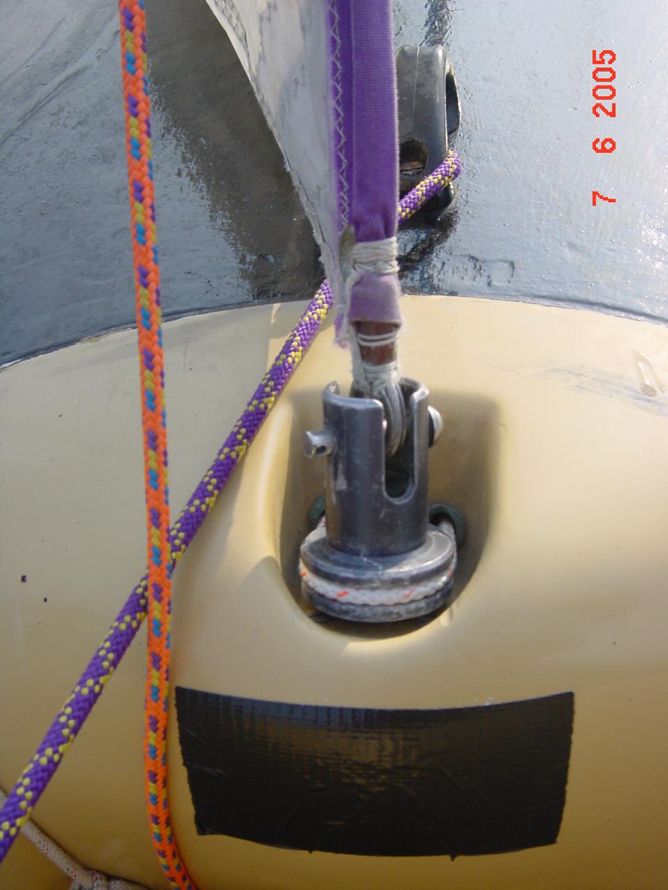

hi, i have a 1988 parker 505, it did have a leak and is now fixed, its pretty much bare hull!!!! i loove it in this state, so simple. i am now onto the fun part, rigging! if anyone wants to help me i would be very grateful. i not sure if there are standard kickers/vangs, outhaul, elastic for trapeze, pole downhaul. etc. since i am new to the class. i was hoping via pictures which would be brillant but whatevers good nick (o and very limited budget) p.s the only rigging i have redone so far is the self launching pole, this is not the new system, rope goes into the back end of the pole, up to mast where it goes down a pulley which is attached to an eye mounted on the mast and then down to another pulley mounted in the front deck and locks of through a cleat, an elastic pulls is back in |

and i forgot to mention i am looking for a new or working order furler to fit this boat, it has to the percific one becuase the front is shaped for it, part goes into the boat and part is out, strange i'll get a picture

You can refurbish the Parker jib furler fairly easily.
Removal from the boat Under the tape shown on the photo should be a rubber bung (might be missing) behind that is a pin that holds the bottom part of the furler inside a tube fixed to the hull. Carefully remove the pin with a pair of tweezers. The whole furler should now come out of the hull. To refurbish the furler At the bottom of the top part of the furler (underneath the eye of the jib luff wire) is a noeprene or similar seal. Remove that and teh bottom of the furler will push out through the top part. Catch all the ball bearings that fall out. Replace the ball bearings, ideally with stainless steel ones, but cheap steel ones come from the cycle shop and as long as the ball race is packed with waterproof grease, they will last a long time. Make sure the ball races do not have any dings in either of them to ensure smooth running. To replace Assemble in reverse order, packing well with grease. Fit the furler back into the boat and replace the pin. If it doesn't have one already, drill a small hole in the end of the pin and thread a thin piece of line through it to make it easier to get out next time. Replace bung or tape. Go sailing! Hope that helps |
