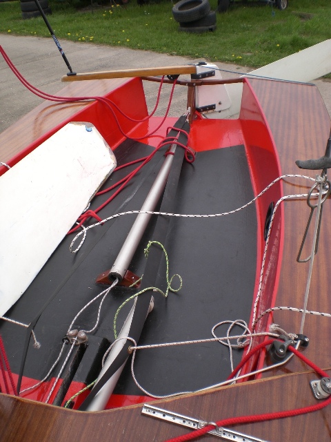

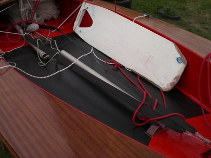

I'ev used a product from A company called Minator UK it is simply an aerosol can that sparys out a textured Epoxy only problem is the limited colours, Black, Yellow and one other can't remember what but is slso available in clear.  Simple to use and cheap to boot £9.99 inc. VAT and Delivery i'm very impressed so far doesn't slip even under water it is agressive but so so much as you'd damage your sailing gear.
 Here's some pics if they work:-
