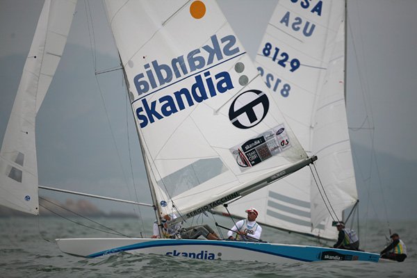

I guess it must be but I don't undetand why it is fast to have the mast so far forwards - I would have thought 90 degrees to the wind on the run would be best for maximum projected area ... Edited by Guest#260 |
It moves the centre of effort towards the water etc etc.

Wind speed is (usually) progressively stronger above the waters surface and could be less turbulent as well. Sailing in this manner therefore projects more of the sail area higher up into 'better' wind. It also balances the rig about the centreline in a way a symetrical spinni would do in many other classes. Perhaps a Star pundit can comment on whether the hull produces less drag when digging in the windward chine. Possibly a combination of all three (and other) factors. Other non spinni classes do it as well without a keel .... OK, Finn, Laser spring to mind and even the Blaze can benefit offwind in lighter stuff sailing by the lee, going deep and with the rig over your head canted at an angle !

Blaze720, I think you are misunderstanding the question, which was: why is the rig raked forwards downwind. You are talking about heeling to weather. http://www.sailinganarchy.com/forums/index.php?showtopic=404 99 is talking about this subject at present. Quite a few keelboat classes do it. So do Merlins, although not to the degree Stars do.

Only on rigs with swept-back spreaders, which applies to all stayed dinghies I can think of and a lot of keelboats but not, I believe, Stars. Some keelboats, such as Stars, have in-line speaders in order that the boom can go out to 90 degrees and rely on the runners to stop the mast toppling forwards. |
Quite - why rake forwards to such a large degree? There is no kite here so what is going on? |

Rick, I'd suggest reading the thread I referenced. One theory is that is develops a flow over the main. I don't claim to know the real answer, but given the competitiveness of the class, if they do it, I bet it is quick.
No doubt it is fast as all the Star guys do it - I was just wondering if this translated to other classes - e.g. Taser or N12. I read the SA thread thanks. Some interesting points. Seems there is two things going on; 1) Raking the mast well forwards 2) Raising the jib Rick
I think we can be pretty confident that sailors of the Olympic coffin have a very good idea about what it takes to make the bizarre rig on that bizarre boat go what passes for fast. I have less confidence that such concepts would be transferrable to higher performance boats...
They're planing boats, not vintage leadmines, so probably not. Also bear in mind the frequency with which Star rigs go over the front... Edited by JimC |
