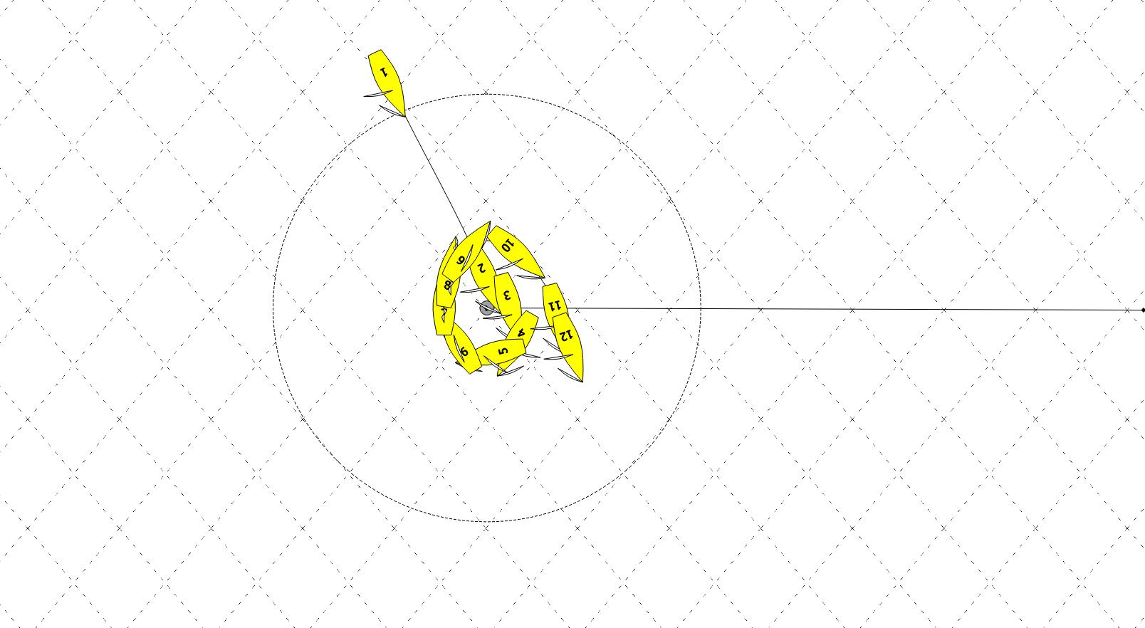

This scenario demonstrates the difference between a 360 degree penalty and One Turn Penalty, and presents some flip-flops in the analysis. ![]() Assumption @1 Y reaches the zone clear ahead of other boats. Y is entitled to mark-room (rule 18.2(b)) @2 Y touches the mark, and her bow also crosses the finishing line Y breaks rule 31. @3 Y is no longer touching the mark, and has begun making her turn to take her penalty for touching the mark. Y begins to be required to keep clear of other boats in accordance with rule 22.2. Suppose there had been another boat, that became overlapped with Y between @1 and @3 and was close to Y @3, there might be an issue whether Y complied with her rule 44.2 obligation to get well clear of other boats before beginning her penalty. If a protest committee concluded in hearing a valid protest that she had not complied with that obligation, then she would not have taken her penalty for breaking rule 31 in accordance with rule 44.2 and subject to being validly protested for breaking rule 31, she would be penalised for that breach.@4 Y’s stern clears the finishing line: she is taking a penalty under rule 44.2 and has crossed the finishing line, so she ‘un-finished’ in accordance with Definition : Finish (a), and is still racing. @4 Y continues taking her penalty. @4 Y gybes onto starboard tack
@7 Y is head to wind, still taking her penalty @8 Y is past head to wind. Y has tacked and has completed her penalty, no longer required to keep clear under rule 22.2.@9 to @10 Y continues bearing away to finish. @11 Y finishes @12 Y’s stern clears the finishing line and Y is no longer racing. Edited by Brass - 27 Oct 20 at 1:46pm |
